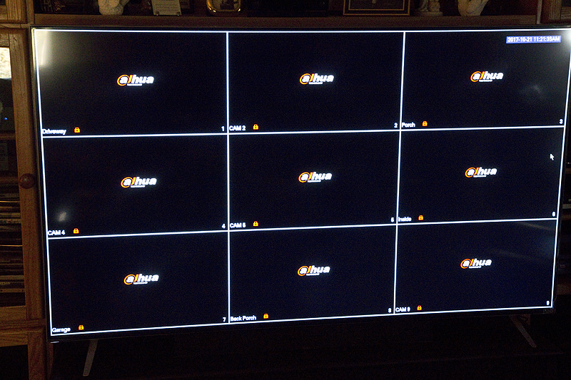

34Ford 0 Posted September 28, 2017 I updated my HCVR7416L firmware last night and now I am not seeing any video thru the hdmi to the tv, unless I log in. Each camera shows a red padlock too. Is this part of the security? If it is now I cannot view whats outside when I am sitting on the couch. Share this post Link to post Share on other sites

tomcctv 167 Posted October 19, 2017 Hi. To answer you need to give more details At the moment you say only shows on tv once logged in How are you logging in if no screen displayed showing If the screen display is showing but not showing camera images and when you have logged in cameras show red padlock Then that indicates you are not logging in with a full admin password (Your using password with restrictions) Go into user accounts and create a new admin password and tick all control options and then see how it goes Share this post Link to post Share on other sites
34Ford 0 Posted October 21, 2017 Before the upgrade I could go to the tv's hdmi input that the dvr is on and all of the cameras was displaying. Not all I get is black screens for all cameras, unless I log in. All my admin options are checked. Share this post Link to post Share on other sites

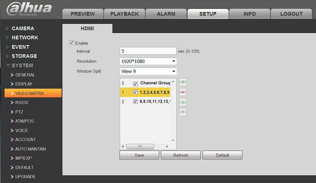

tomcctv 167 Posted October 21, 2017 Hi. That is not your home screen it is the matrix screen. You need to set cameras to view Click on system then on left hand side click video matrix then click on cameras you want displayed Share this post Link to post Share on other sites

34Ford 0 Posted October 23, 2017 Well I tried every possible thing I could in the matrix screen. Still not showing the cameras when logged out. Share this post Link to post Share on other sites
Neutech 0 Posted November 2, 2017 You need to setup the default user to have authorisation to live view the cameras Go to password setup and select default user then on the Tabs liveview and select all Share this post Link to post Share on other sites
34Ford 0 Posted November 5, 2017 You need to setup the default user to have authorisation to live view the cameras Go to password setup and select default user then on the Tabs liveview and select all Hallelujah, you da man!!!!! Thank you so much. Share this post Link to post Share on other sites
