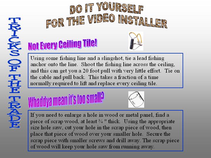

Tricks of the Trade - For the Video Installer - Part 2 of 5
i always want to try these wire pull tricks but the ceilings that i go up into have so much pipes, wires, insulation, wires, crap, etc,etc that trying to do any type of slingshot fancy shooting unfortunately doesnt work
I used a expandable cane type pole...........25ft. easy..............you can direct it as you extend it. good for up to 4 cables at once.....with someone on the end guiding it.
This method helps out on certain installs where you have the realestate above the ceiling tile, but I agree with you both for crowded areas.
As an alternative, I use the following Creep-Zit from Labour Saving Devices.
Each fluorescent 6 foot fiberglass piece has screw-on couplers, so you add the links as far as you want. The egg beater looking piece helps keep the rods from getting stuck on the ceiling tile supports. The fluorescent color makes it easier to see and retrieve in crowded spaces.
yeah i have the "fish sticks" that i use a lot.. most of mine are badly injured from use - the ends are broken, etc.. but they do help... i'd like to teach one of those mini chihuahua dogs to pull wire for me but havnet had the time to train one yet
maybe that new robotic sony dog could be taught to run along the ceiling tiles and pull cable
wire cutters tied/taped to the end of the wire... then just chuck it in the direction you want .. at least that worked with telco wire
extendable gopher pole,,,the greatest,,,25' plus your arm and you can go over all things to keep cable off the ceiling and away from flourescents. be smart though, go to the other end and fish it then go attach wires and PULL. i have pulled 8-10 cables at a time this way with no problems.
