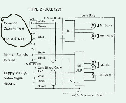

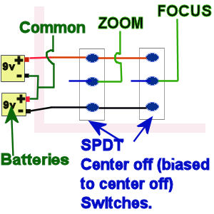

There are different ways of connecting certain zoom lenses, what model lens are you trying to connect? The following is a quick diagram showing how you could use a couple of batteries and a couple of three way toggle switches (left, center off (normal pos), right) to control both focus and zoom. This is for lenses that have a focus, zoom and common connection.

A example of a pentax lenses details, which has the required common, zoom and focus to connect to the above...
If you have two wires for zoom, and two wires for focus which are direct wired to the each motor then you can connect one focus and one zoom wire together to make the common (you will need to make sure you get the right ones so the switches dont operate in reverse for zoom or focus, experimentation is often the only way if you have no wiring diagram for the lens)
The above assumes the lens has nothing more than a motor controlling the zoom, and a motor controlling the focus (we are not connecting anything to the iris circuits here, you do them seperately if needed) which all I have seen are.
You can use individual switches if you want instead of toggle switches, just rearrage the wiring to get the same effect, but be careful the user cant press zoom + and zoom - (or focus + and focus -) at the same time as that would short out the psu or batteries.
Remember a small votage drop will usually not stop the lens from operating, but it will make it slower as the motors have less voltage to operate.
So... You could use this to your advantage, you could make sure the lens will get the correct voltage for full speed operation at all times, BUT put a varialble resistor (potentiometer) into the circuit to lower the voltage as and when required, this could be mounted on a diy control panel next to the switches and could be used for fine control, ie very slow focus/zoom when required.
