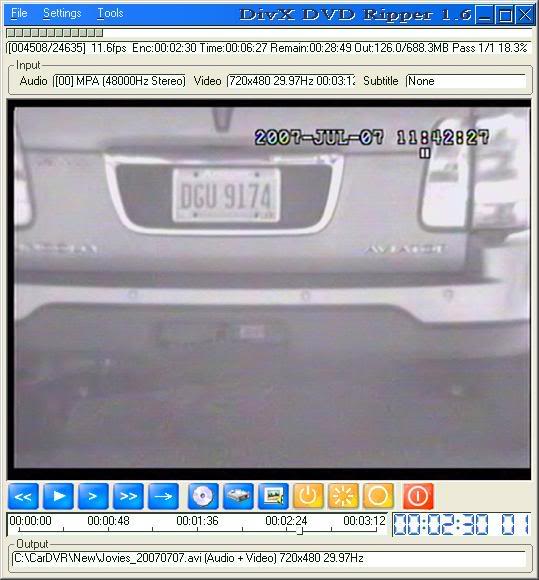

Picture 1
Taken from a photo camera of the GUI, you can read the number here too.

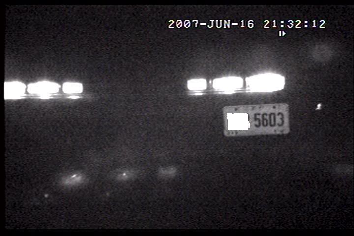

Picture 2
Taken from a photo camera of the outside cameras, not the cameras we usually use, but they wanted some cameras matching the 200 000,- USD roof.
This has been working good for 5 years soon and it is good quality 24 hours a day. It have good help from the outdoor lights!
Angle, camera, lights, and how big is the plates on the recorded files and what compression and how much compression!
