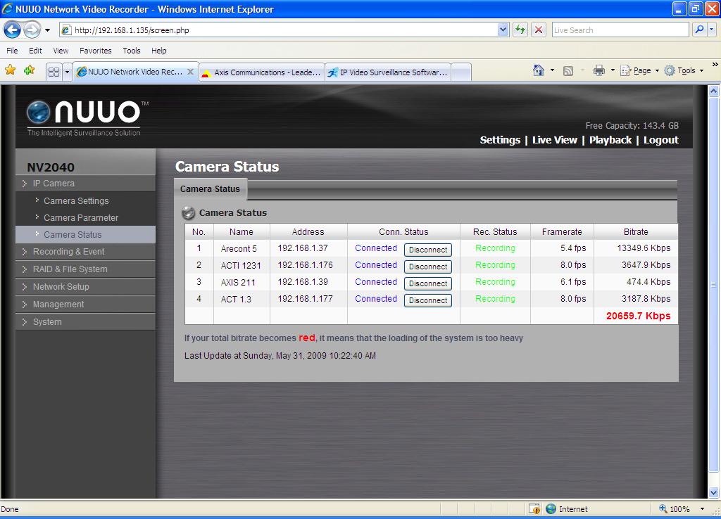

Sorry was a little vague with my last post. Looks like the total bandwidth for the 4 channel is 20 megs. Here is a screen shot:

Well just means you can't use 4 5mega pixel cameras on the system. The question is what is the limit on the 8 and 16 versions. Over all this is the only thing that I don't like about the unit.

NVRmini can handle full data rate of cameras. However, to balance the computating power and data I/O given nvrmini's spec, we limit the bandwidth that an nvrmini can handle to ensure the quality and the user experience.
NVRmini 2040 is capable of 20 Mpbs.
NVRmini 4080 is capable of 30 Mpbs.
NVRmini 4016 is capable of 22 Mpbs.

The reason NUUO limits the bandwidth on 4016 is because NUUO wants the hardware to process the incoming video more smoothly and more stably since it supports more channels than 4080 does.

For the 16 channel I actually need 9 cameras. With 9 cameras I'm looking at a minimum of 27Mbps. The little mini will choke. I can decrease my requirements and probably live with a lower FPS to fall within the limits of the NVR but no way can this machine make someone happy with populating all 16 channels.
