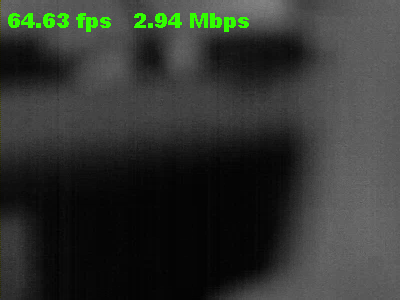

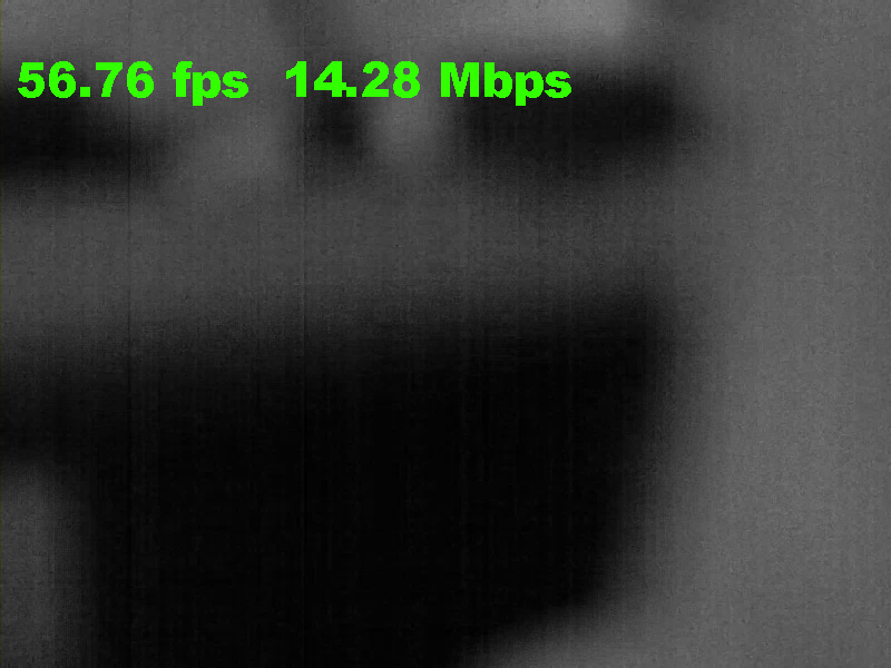

As for data rate, I was getting over 30 FPS reported in the screen footer with the AV3130 in LR but only with the video resolution setting at "half". The recorded rate was about 20FPS. My guess is I have some issue with my PC.

Sorry I didn't have time to focus the camera but I wanted to show you that I could get 60+ fps with a Arecont camera and there software. Once the camera is focused FPS should go up. I am using a Supermicro server, single quad core xeon, with 4 gigs of ram and I don't know if this makes a difference but I am RDP'd into the machine. Also I the camera is powered with POE from a linksys switch then a gigbit link to my main Zyxel gigbit switch where the server is plugged into.
800x600
400x300
