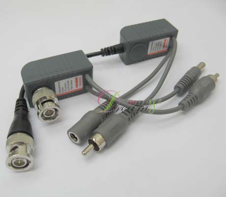

how about this type of balun, i found on google, does power, video and audio via cat5 cable which i have stacks of. if i bought a few of these and stuck it on my camera and dvr using 24vac through it i can run all my cameras without the need for coax cable? if this is ok it will save me a bit of cash. then i would just need a fig8 cable for my IR light.

Design for transmits audio , video and power over a single cable.
Longer transmission distance, 600meter.
Support all video device, such as camera, monitor, DVR card, recorder, etc.
Route 12VDC/24VAC power via cat.5 cable .
Lightweight and compact ,simply install.
Come in pair ,one for camera ,and the other one for DVR.
Package content:
1 X CCTV Video Audio Power Balun Transceiver
Video: Frequency Response:DC-6MHz; Common-mode/differential-mode Rejection:15HKz-6HKz 60dB typ.
Wire Type: Spec:24AWG or UTP CAT5 ;DC loop resistance:18Ω /100M; Impedance:100Ω Â±20%;Differential Capacitance:62pf/M(Max.)
Impedance: BNC coaxial cable: 75Ω ; RJ-45 100Ω
Temperature:-10~+65℃ Humidity:0~95%
Transferring Distance: 200 M
Dimensions: 20x20.5x43cm
Weight: 35g

Thing is, there's nothing really special about these, as baluns go. The most basic video balun connects the BNC pin and shield to a pair of terminals, lugs, screws, or pins on an RJ-45 jack, via an appropriate transformer.
The ones that add power, simply connect the power input/output leads directly through to two pairs of pins (so you double-up the wires for better current capacity) on the RJ-45 jack.
The ones with serial control do the same with the fourth pair of RJ-45 pins, and I would suspect the ones with audio do the same (although they COULD use another transformer for proper balanced audio, I doubt that's the case, at least with most cheap ones).
Basically, there's no functional difference between using one of these all-in-one devices, and just plain video-only baluns and then tying your audio, serial, and/or power directly to the wire pairs in the Cat5 jacket... all these do is simplify the installation a bit.
