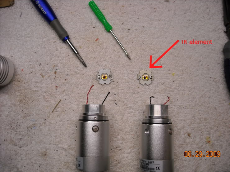

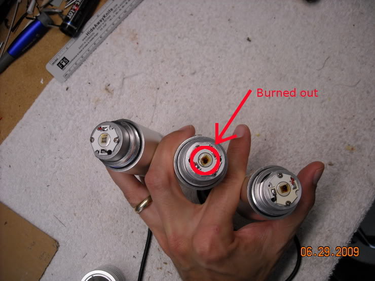

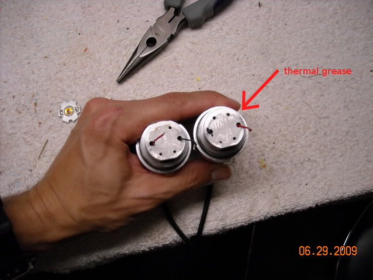

Sawbones 0 Posted October 9, 2009 Most important - life expectancy of the IR's Yep. I purchased a couple of them on Ebay: They lasted six months... note the burnt-out IR array element (the leftmost one is still good) Share this post Link to post Share on other sites

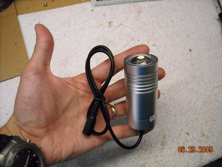

Sawbones 0 Posted October 9, 2009 I'm still using a couple of them, but based on my experience thus far, I don't expect them to last. I think they simply get too hot (there is heat sink compound behind those little "star" IR elements) And here is the little piece that actually generates the IR: I actually like the way these things work, and they throw out such nice, even light. I just wish I had more faith in their longevity. Ah well... at 50 bucks, what can you realistically expect? Share this post Link to post Share on other sites

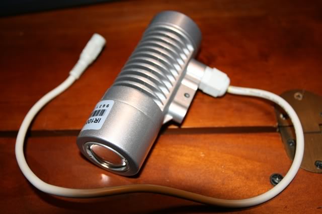

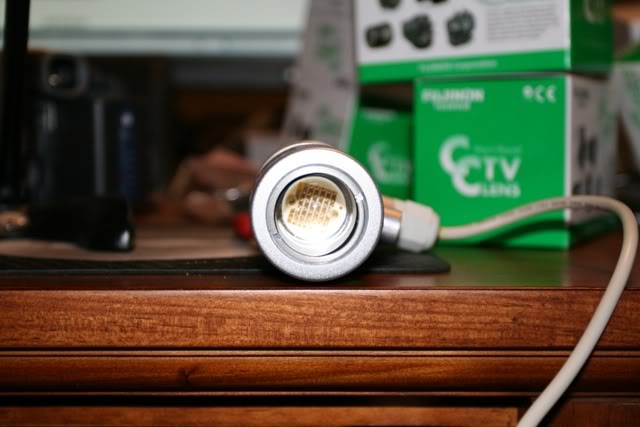

dopalgangr 0 Posted October 9, 2009 Hmm, minds a little different. Instead of the four IR leds like yours, mine has a whole array of them. Maybe thats why it cost more? (75) Share this post Link to post Share on other sites

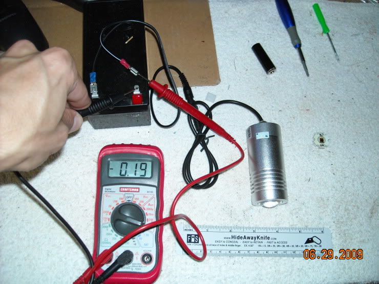

Sawbones 0 Posted October 9, 2009 How much current does yours pull? This one only pulls about 200mA Share this post Link to post Share on other sites
dopalgangr 0 Posted October 10, 2009 Well, I dont have a 12v battery to have a setup like you to tell you exactly. I did find the link though, looks like they went up in price. http://cgi.ebay.com/Outdoor-Light-Illuminator-for-CCTV-Camera-100M-IR-Led_W0QQitemZ260329350247QQcmdZViewItemQQptZLH_DefaultDomain_0?hash=item3c9cd6a467 Share this post Link to post Share on other sites

dopalgangr 0 Posted October 11, 2009 Well after replacing the fuse in my meter I was able to perform the test. It pulls 350mA Share this post Link to post Share on other sites
rory 0 Posted October 11, 2009 hmmmm .. the Extreme EX82 cameras draw 1-2amps. But thats the camera as well as the IR. Share this post Link to post Share on other sites
