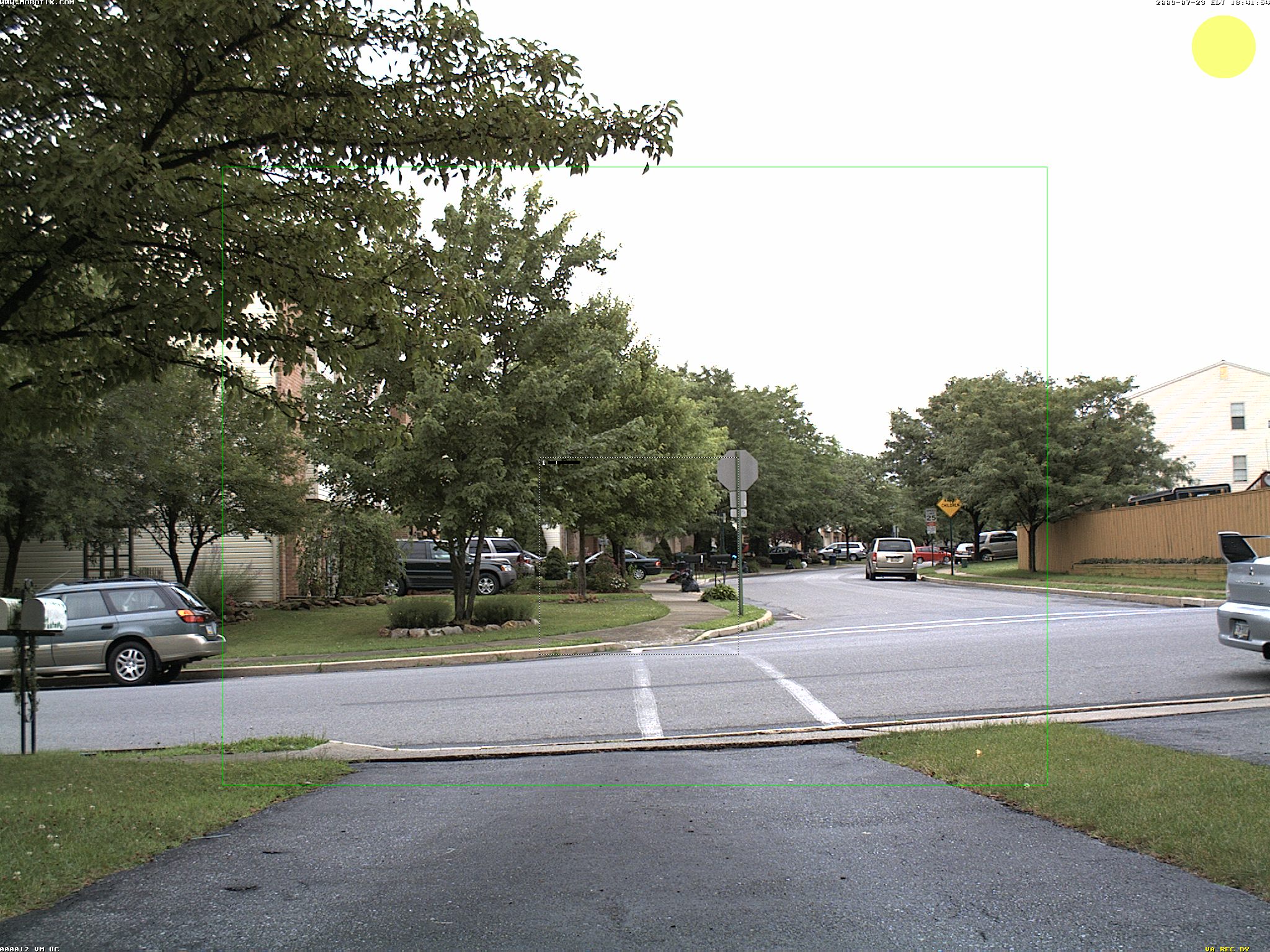

thewireguys 3 Posted November 8, 2009 its not that great.CMOS sensors, i wonder how they go in changeable light. you still need a recorder. you need 300+gig storage, 16gig internal just won't cut it. and then theres price. ~$2000 (by the time you buy the extra cameras) and then you need to buy the recorder. Mobotix has one of the best megapixel images in the industry. That price is with 2 3MP imagers which is more then enough to cover the inside of the car and can see out of the windows if placed properly. Also you don't have to buy any extra dvr/nvr solutions it's built into the camera. If you know how to setup logic in the camera for recording events the 32gig of SD storage would be enough for a couple of days. Also if you need more you can at a usb harddrive directly to the camera which could give you months of storage. Mobotix 3MP image Share this post Link to post Share on other sites
tweak'e 0 Posted November 9, 2009 picture wise they look great but what are they like with high speed motion and changes of light ? for the type of use you need to be able to have months of storage. so when you get sent a ticket a month later you can actually go back and reveiw it. any added hardrive needs to be able to record all cameras at once. (2-4 cameras) constantly rather than event based. event based recoding is fine for a crash camera but for other uses you need constant recording. megapixel cameras would be fine with 1TB hardrive recorder. Share this post Link to post Share on other sites
zmxtech 0 Posted November 9, 2009 The Mobotix CMOS sensors are very good for crazy lighting, unlike CCD's they can handle direct sun light no problem. At first I was hesitant on CMOS then I did the Mobotix course and was impressed. The shutter speed can be adjusted to suit like 1/1000 to capture cars flying past no problem. Share this post Link to post Share on other sites
