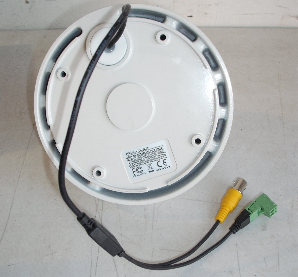

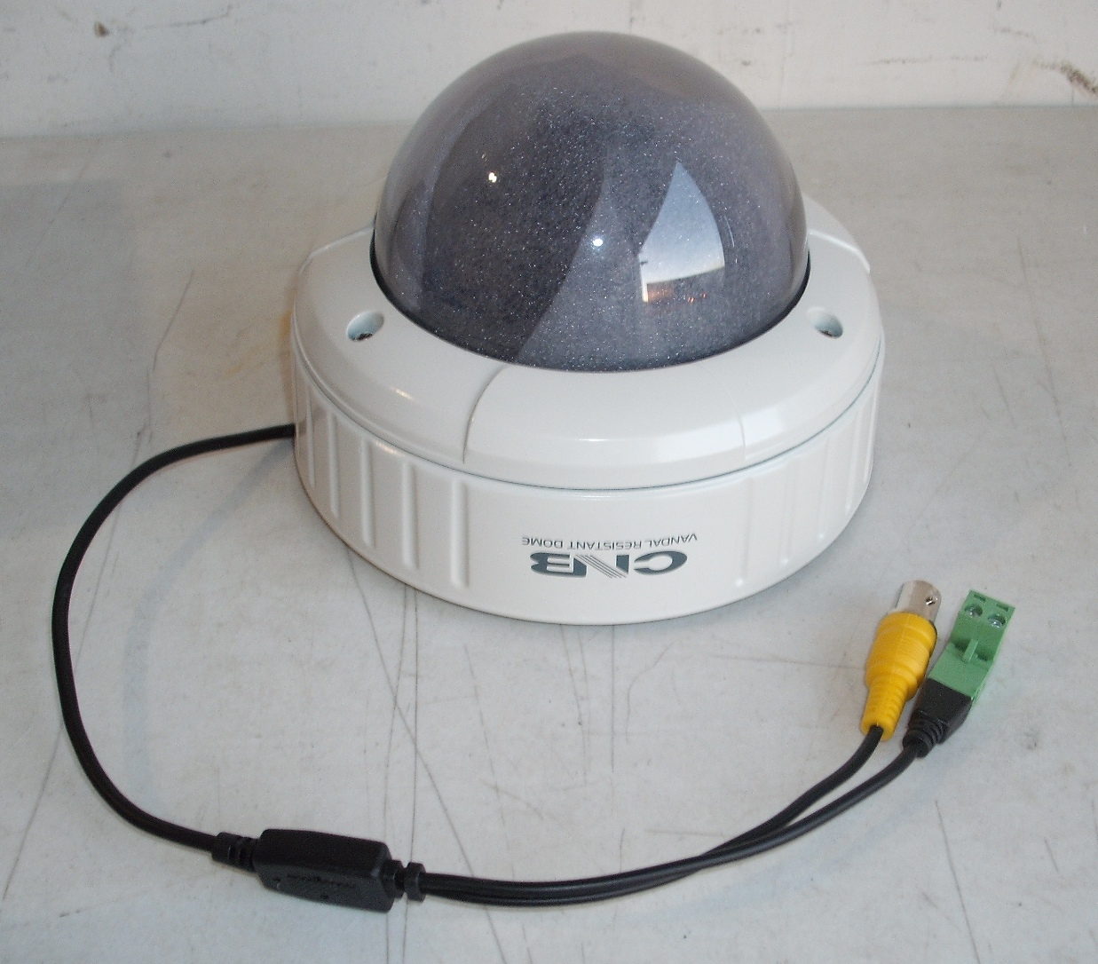

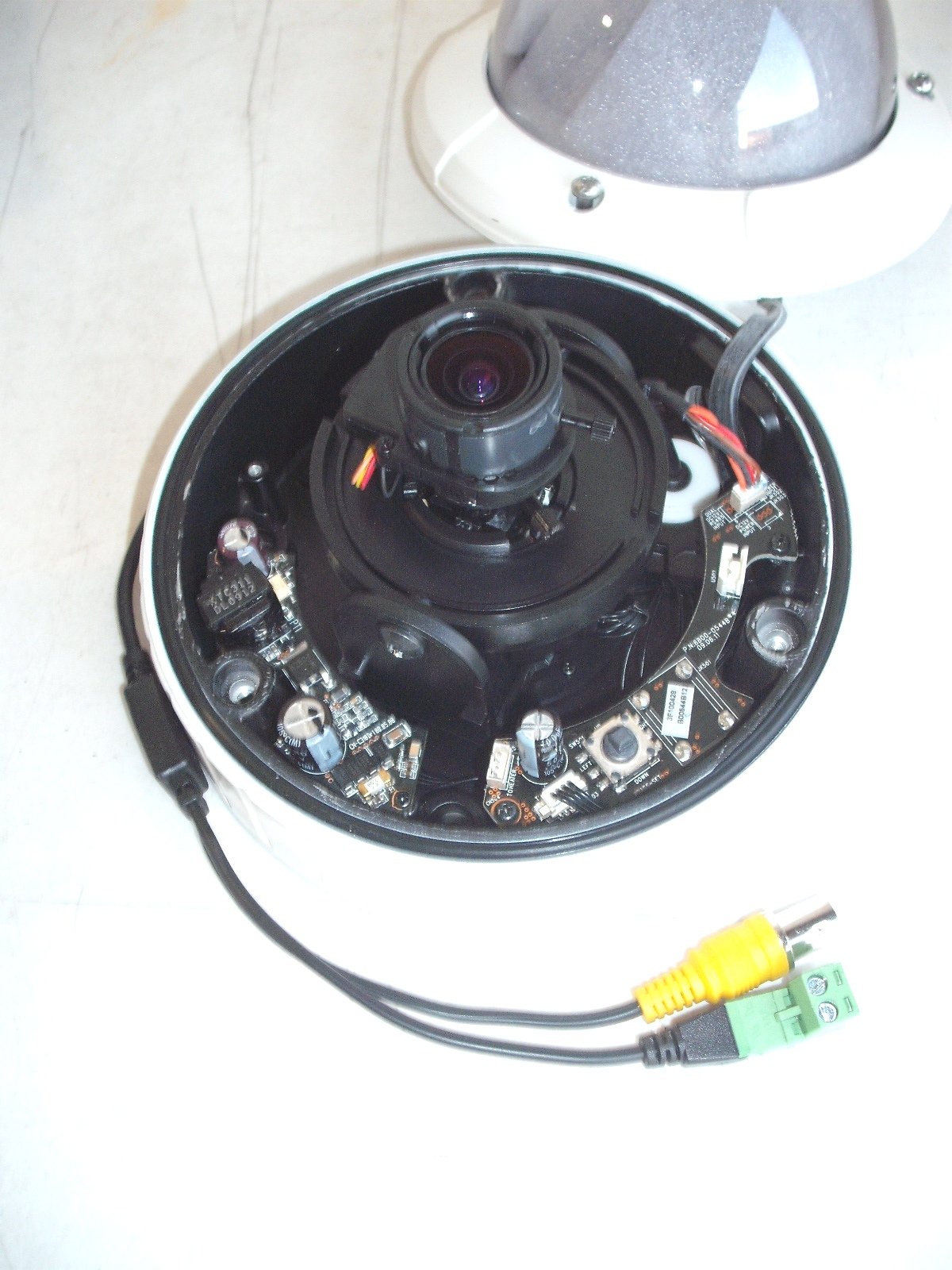

The green plug in the above picture is your power. It has two set screws for hold your wires in.
I don't see why you couldn't mount it on a wall above a door. The VBM is recessed and the VCM has a surface mount bracket included.

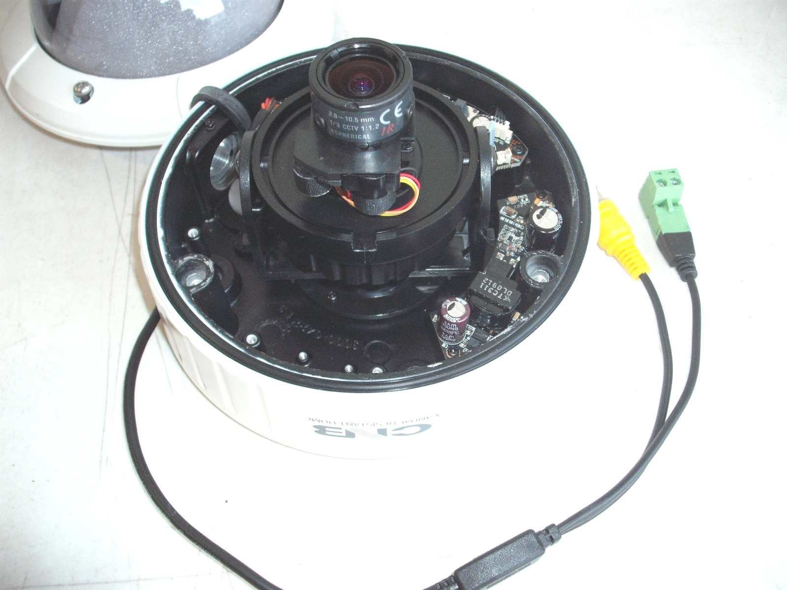

That's correct, they came from surveillance-video dot com with the same specs as the cnbusa site. The lens itself says '2.8-10.5mm' and oddly enough on the surveillance-video site, they spec it as 4-9mm as well.
Unless it's a revision on the model, I would assume it should be the same as the cnb site.

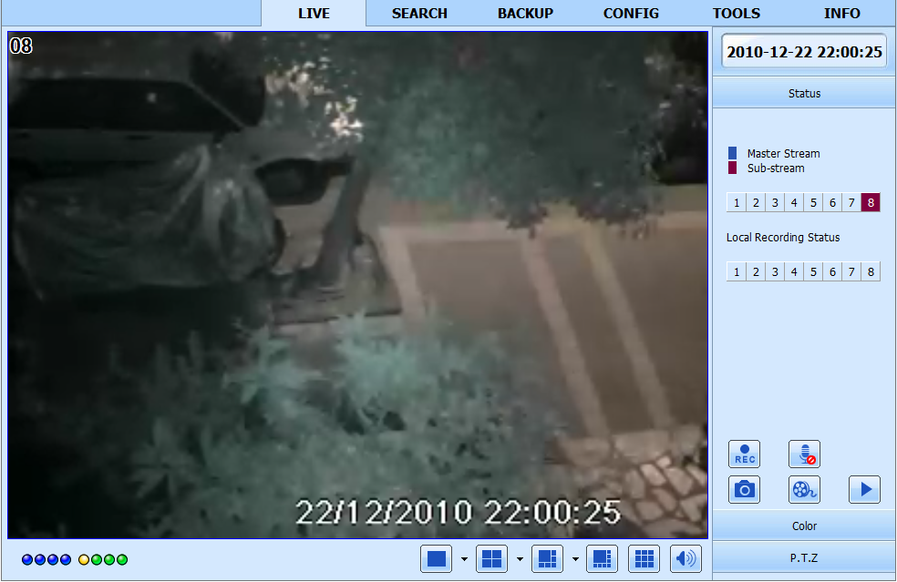

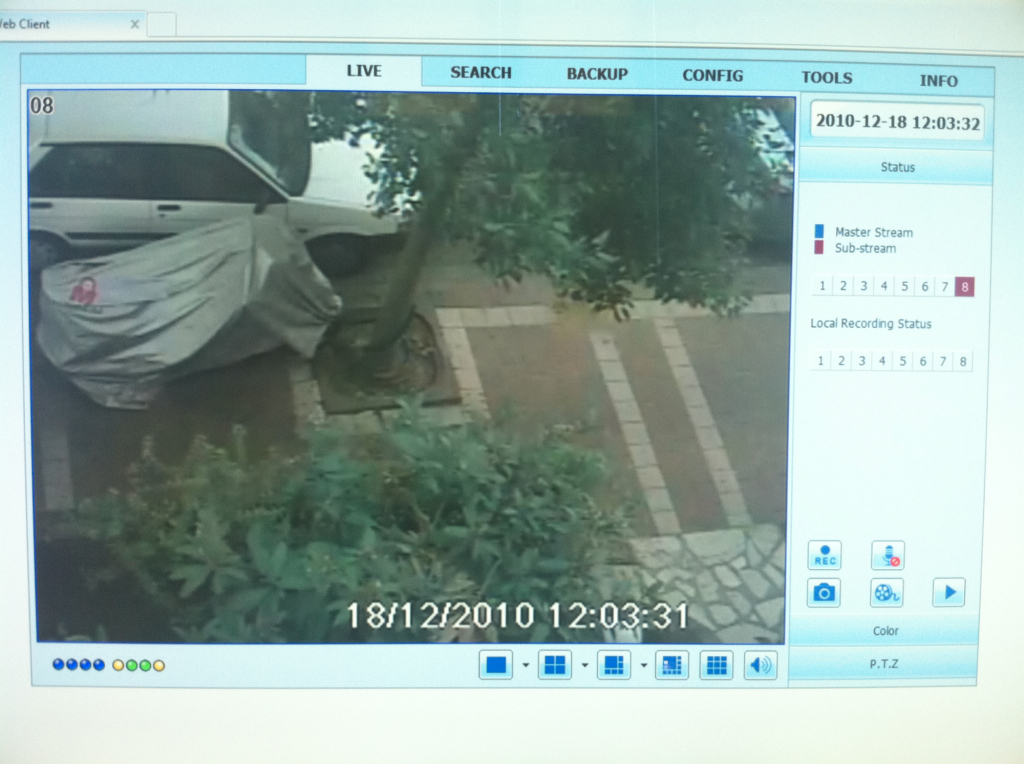

i need a good camera to replace the current $60 camera i got from http://www.safer.com.cn that keeps an eye on my bike.
On the bottom image, at night, the light that comes from the right side makes the image flicker all the time, also the image
is not crisp as i want it to be.
the distance from the camera that sits outside my window 3rd floor to the bike is around 50ft, it looks closer cause i zoomed it to be able to see all the bike and the front entrance to the building.
do you think the vbm-24vf will be a good purchase for my needs ?
At 12:00
At 22:00

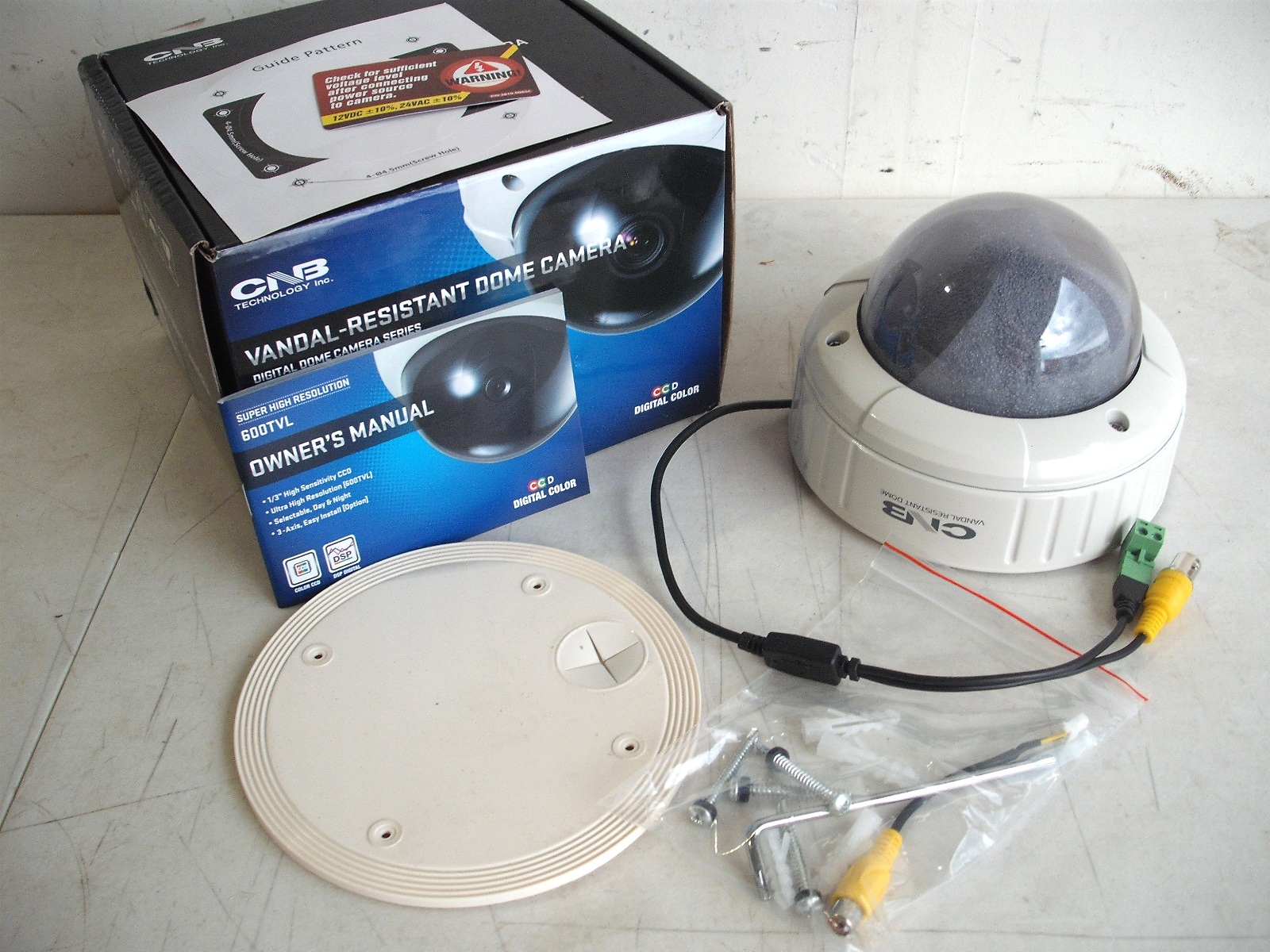

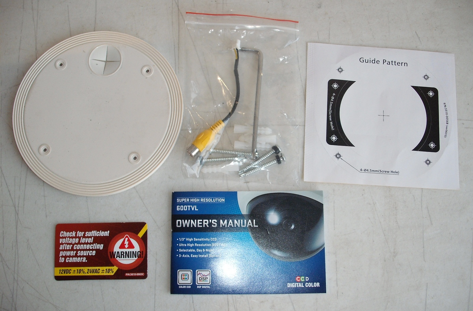

Just in case some one wanted to see actual images of the vbm-24vf, i found some good ones, click on them to see them in actual size...
