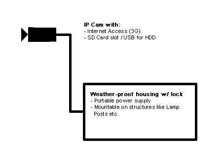

IS there such a device or is there anything like that which can be done?
The setup is for a portable CCTV system that can be mounted onto lamp posts and detached easily (or relatively easily) for re-deployment. The most tricky part I can see is a independent power supply. I've suggested solar panels to my prospect but he felt that solar panels are too expensive. Hence I am thinking of something like this:
An IP cam with
1) SD Card Storage or USB Hard-Disk output (I've seen before a year ago from China)
2) Optional 3G internet connection
A weather-proof housing that will store a power supply. Either a Battery or a UPS. Or anything else.
Does anyone has any suggestions for such a setup?
An IP cam with
