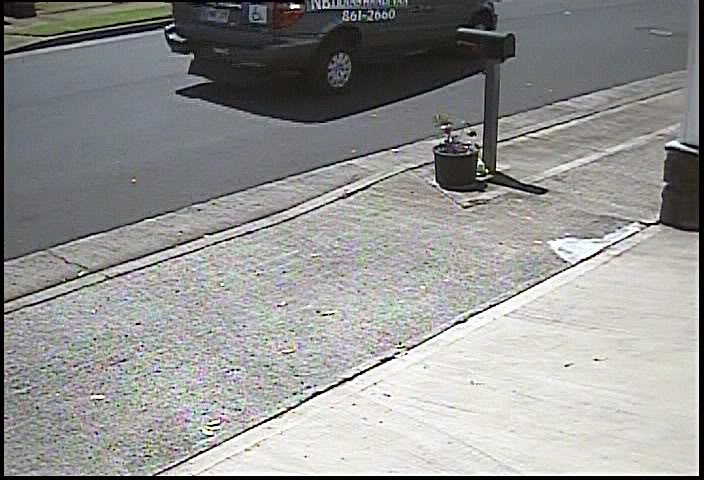

There were some water spots on this camera, but I still would not be able to tell. You can see the pixelation in this still which was pulled directly from the dvr.

As to the image in the link you posted, there is something horribly wrong with either that camera, DVR, or the capture method you used - even a $5 camera from china looks better than that
this is it resized down to 320x240. It is still horrible. Ive had similar terrible results saving images from captured video from this cheap Avtech DVR I have. But the Avermedia? It looks like perhaps you just used the remote software and clicked snapshot to save the image, and in that case that would be why you are saving these images in quad view, or full view. I just tested the same on a EB1304net and the images although locally are great, even the remote image is good, but the webcam snapshot is awful.
It was downloaded to a usb drive then I took the snapshot. The other pictures in quad view were snapped i the web application (webviewer). I also played it back on the dvr itself to verify, no difference. I spent days trying to identify the car but could not make anything out. It was very bright out in the morning. I have noticed the brighter things get the worse picture I get. Around dusk yields the best picture.
Tell me about it. I have tried everything with the settings on the cameras/dvr etc.
I am having the same issues with the image.

That is more what I am looking for. Something where you can at least tell what type of car the person has after they rob you. That way I can be on the lookout for the SOB. I doubt it is my DVR causing this issue as it did not happen with my other cameras. If anybody wants the CNB's then PM me and 100 each plus actual postage they are yours. I need something better.
Your DVR is not going to produce images anywhere near that resolution, I don't care what analog camera you connect to it.
It is at D1, I have checked the settings. Can I post the actual jpg here? I have it on my computer but do not see a way to add the file.
There is no way that can be D1. It just looks crappy if I am being honest. If your DVR is set at D1, then there is something wrong in your system, whether it be the camera, DVR, cable, connector etc. I would agree with a previous poster that that doesnt even look as good as CIF. Before you sell your CNB domes, I would do a bench test with the camera and take the DVR totally out of the equation. Take the CNB dome down, get an RCA cable with BNC adapter and plug the camera directly into your TV or monitor and see if you get better results.
Here's a recorded snapshot on a Lorex 20" all in one from the VBM-24VF. Bantham1 said his other cameras don't have those jagged edges, so I don't know as I thought it was maybe the de-interlacing feature on his dvr gone bad or maybe if a firmware update would help. The van is going down the street at about 20 mph.
