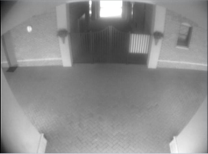

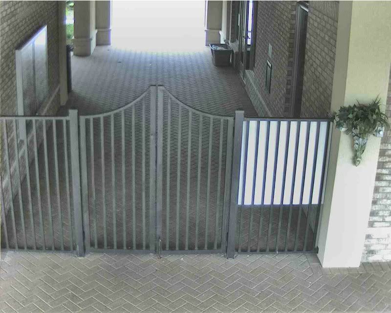

I did a system change-over this summer for a local neighborhood center, from analog to IP. It went from this:
To this:
The former is an old 380TVL Pelco B&W... the latter from an Acti TCM-7411 dome (resized to 800x640 for this pic). It's only 6-8 FPS, but with far better picture quality. In fact, it's been more than good enough to ID perpetrators on two occasions so far. The management folks are VERY happy with it.
Picture quality matters.
^ thats gotta be on of the dirtiest cameras ive seen yet
Yeah... it was pretty bad. I don't think it had ever been cleaned.
I dont get some clients .. they are like the camera is blurry and out of focus .. or has all kind of spots over it at night ... like yeah its been raining for 2 months straight what do they expect
