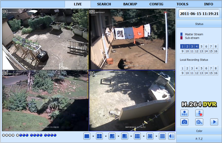

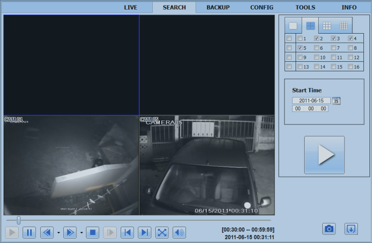

Finally got my QT428...
I'm pretty happy with it so far... But I am having trouble viewing playback from another PC. It shows it live nicely, but when I hit play, it say a codec is needed, click to download. So I do, and install, and still doesn't work. Same message...
Both PC's I tried it on so far, are Win 7, one is 32 and the other 64 bit...
Same message on both...
Any idea's?
Thanx,
Ron
Probably restart IE, and if it says anything else about the codec, set it to always run, use, etc it. Basically, tell it to USE the codec.
Internet Explorer is DUMB when it comes to these things!!
