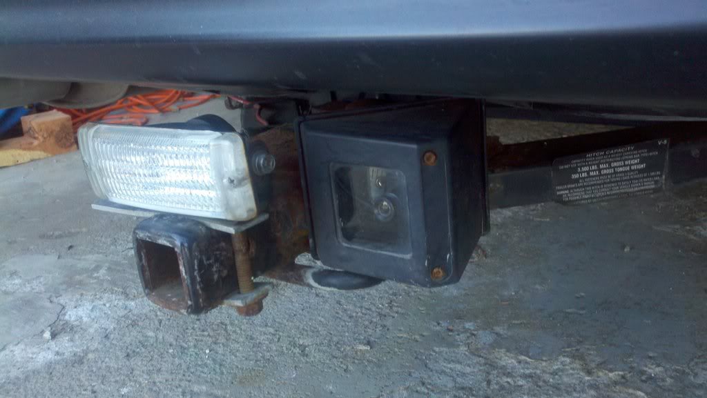

I use a small mini cam with mirror function in a housing on my tow bar.
I also have the screen in my car set up so that when I put the car into reverse the video screen switches over to a full screen backup view. Works great. Backing up is a breeze.

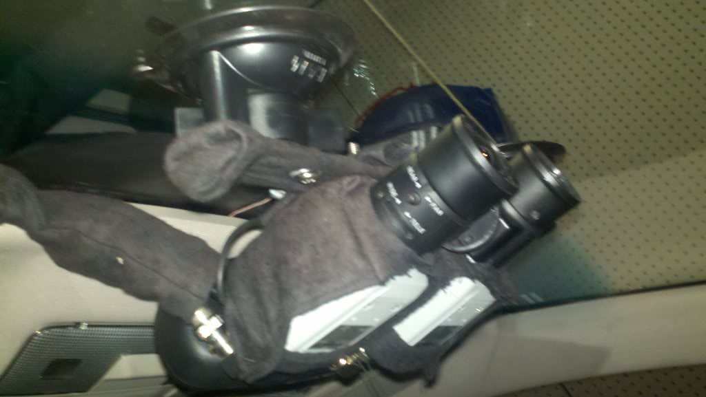

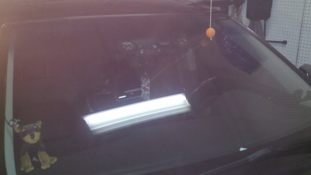

I have two front-facing cameras. Both identical, except one is zoomed in really tight and can pick up a license plate from 3 carlengths away, and the other is a really wide-angle lens that can see traffic light color until I'm well past the line. I find I need to run both cameras to get the best coverage. I suppose you could run one single full 1080P camera (gs600 dvr) and then still have enough resolution to get something of a 'zoom' effect in the middle... But I also like having two cameras looking forward in case one fails. (happens more than you think, usually vibration causes a connection to work loose)
The front-facing cameras are bolted to a strip of aluminum that is attached to two RAM suction mounts. All of those parts are covered in black fabric. The combination of dark tinted windows and black fabric mounted behind the sun strip across the top of the car makes the cameras almost invisible.

nice way to do the front cams.
