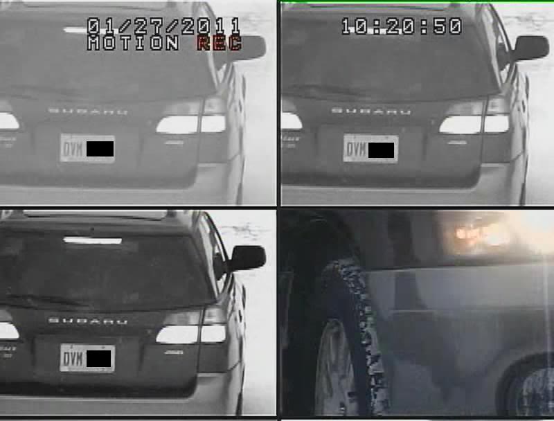

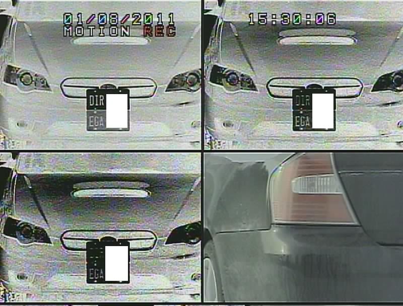

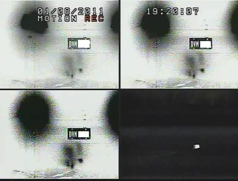

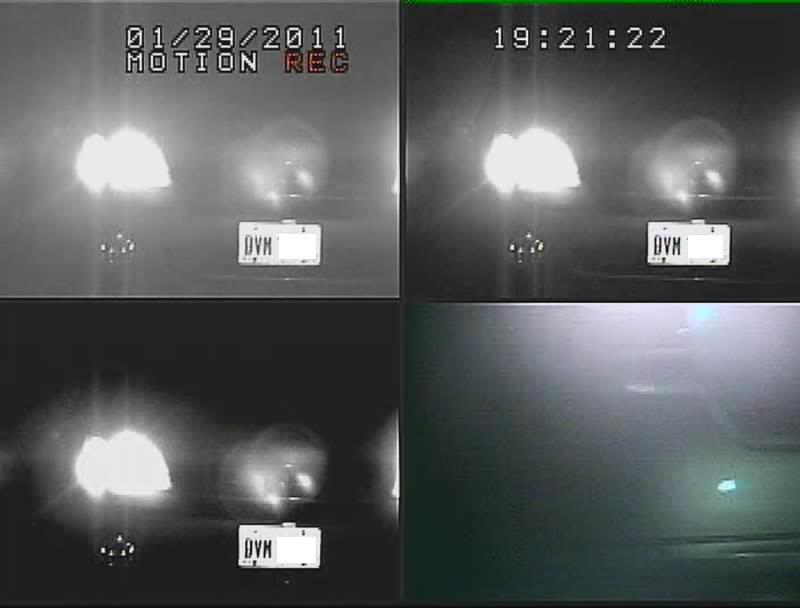

Scruit 0 Posted January 9, 2011 So here is what I have now with the CNB605 installed... Before: (day) After: (day) (The top plate is exposed as normal. The bottom plate has a smoked cover) After: (night) I need to get my hands on a printed plate to test it... Also, in my other thread I noted that the the combination of D/N mode in Night and WDR On causes the camera to black out for a split second every couple of seconds. Share this post Link to post Share on other sites
