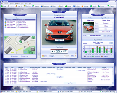

rory 0 Posted January 5, 2011 automated license plate recognition is not the same as ALPR which in true terms means AUTOMATIC LICENCE PLATE RECOGNITION also known as anpr. the cameras dont see numbers its a very powerful algorithm set to read plates from upto a mile away and at speeds of over 100mph and your looking at $15.000 each. information from a ANPR camera licence number colour and make owners details tag check outstanding fines insured or not persons wanted. Sounds like the software on the PC that does that, at least how most are. Or you talking about cameras that have the software built in to do this? Automatic number plate recognition can use ANY camera though. http://en.wikipedia.org/wiki/Automatic_number_plate_recognition Share this post Link to post Share on other sites

Bean00 0 Posted January 5, 2011 automated license plate recognition is not the same as ALPR which in true terms means AUTOMATIC LICENCE PLATE RECOGNITION also known as anpr. the cameras dont see numbers its a very powerful algorithm set to read plates from upto a mile away and at speeds of over 100mph and your looking at $15.000 each. information from a ANPR camera licence number colour and make owners details tag check outstanding fines insured or not persons wanted. Again, I'm not talking about the software itself. The Cameras are specified in order to provide the necessary amount of information for ALPR(or ANPR) to operate effectively. The camera isn't doing the work - but ALPR/ANPR software requires more detail than the human eye to identify plates and Bosch/Extreme spec their cameras to provide that level of detail. And again, I was only pointing out this fact to state that since he ISN'T doing ALPR, he has a little extra wiggle room on those distance numbers. 18% is ok for a license plate. 20% is better. The bigger you get the more you you lose in focal width running the risk that cars will drive too far left or right and you'll miss the plate. More is always better. 18% is just the number Bosch uses. And since they tend to be conservative on LPR capture, I went with that number . Share this post Link to post Share on other sites
