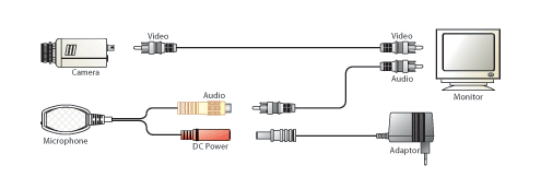

Numb-nuts 1 Posted February 15, 2011 When I first became interested in CCTV it was as a result of chatting with the guy from our local council's Anti-social behaviour team, who installs CCTV in victims homes for evidential purpose. We have had many chats since then and I've even loaned him some equipment which fitted with particular situations. He contacted me this week saying he was setting up a surveillance for a family that are subject of "racist hate crime" and verbal taunts are a big part of the harrasment they are experiencing. I have a microphone to loan him, however I understand that there are some issues with sound synchronization with the picture frame rates etc. Firstly how is the connection done? Second what recording parameters are required to sync the sound and picture? Remember, the captured sound and video must be evidential quality. ANY ADVICE OOH Just found this. Share this post Link to post Share on other sites

ak357 0 Posted February 16, 2011 Staying on thread, does anyone have any technical advice for ensuring recordings are in sync with the sound? What are u going to use for video recording ? as long as u use Real time for video u should not have problem with audio Share this post Link to post Share on other sites
Numb-nuts 1 Posted February 16, 2011 Thats interesting, what do you consider to be real time? Personally I record at between 6 to 12 fps which is ideal for evidential purposes and is not so poor that fluid motion is lost. I hear talk of computer video editing and often hear that 25 - 100 fps is desirable. Most DVRs that I have seen record at a Maximum of 25 fps so is that what you mean as real time? The DVR the council uses records at around 6 - 12 fps and is accessed via the 3g network so file size is an issue, however if it is just a matter of the frame speed keeping up with sound files, I can always loan them another DVR as well as a microphone that they will have to attend to download evidence. I think I'll do a little trial run to see if that is all that is needed to achieve synchronization of sound and video. If I do some testing at differing speeds until I find the one that is the optimum. PS AK, your little crawling ant drive me crazy Share this post Link to post Share on other sites
Soundy 1 Posted February 16, 2011 The only DVRs I've actually used the audio features on have been Vigils, and the audio syncs just fine with the video regardless of framerate, no extra tinkering required. I've seen it used on a couple old MUX/VCR installations and there was nothing special done to sync that, either. With lower framerates, the picture may "skip" along, but the sound shouldn't, and it shouldn't go "out of sync" with the picture... or if it does, it should be only offset by a fixed amount (it would take upward of 100ms to really be noticeable) that can be easily compensated for on playback. Have you tested this yet with the setup in question, or are you just assuming there will be issues because someone told you there would be? Unless it's a really low-quality DVR, I don't think you'll see any issues - again, if anything, I would expect the sync to be off by a fixed amount, probably no more than a few hundred milliseconds, through the length of the recording, so it should still be easy enough to tell that the audio "matches" the video. I can't think of any reason the offset would "wander" through the timeline. As for checking on the legality, the point is that you could save yourself some time and trouble worrying about the sync issue if you find out that it IS illegal. Plus, if it's illegal, and you just supply your client with the microphone to do it, you could be opening yourself up to a lawsuit, if he were to be caught and charged and then claim that you, as the "CCTV professional", "should have known and warned him of the potential liability." Share this post Link to post Share on other sites

Numb-nuts 1 Posted February 21, 2011 Thanks for that. This confirms what I thought would be the case, an omnidirectional mic (like the one I am loaning) will be eminently suitable in this case. I have advised my friend to place the mic under the window sill of the property on the 1st floor. The family that are being victimized are suffering regular verbal taunts, recording this combined with footage will be powerful evidence because it will give a fuller picture of the offenses being committed. I have experimented with the mic and DVR and above 12fps there is no problem with syncing sound and video. The only problem is if there is a prevailing wind across the mic (never expected that) and this is easily solved by masking the mic with a foam wrap. All sorted done and ready to go. Thanks all Share this post Link to post Share on other sites
