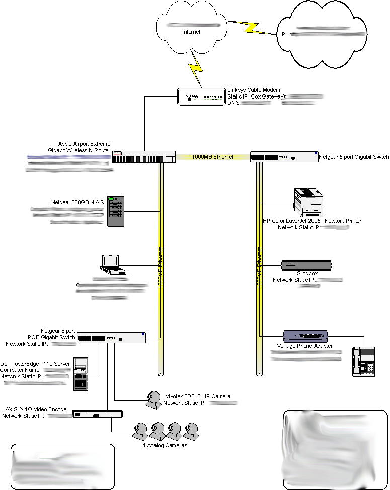

Not sure if this will help or not, but here is a very basic diagram of my home setup that I just threw together, which involves IP and Analog cameras. Click on the image for the larger sized view so you can see it better.
Just run the analog cameras through an encoder, and then plug them into your switch. WIth the IP cameras, just plug them right into your switch. I have all of my CCTV-related stuff plugged into their own POE Switch.
