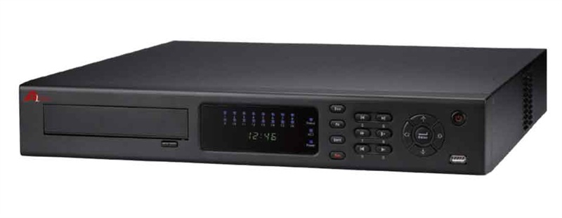

seanfry 0 Posted September 30, 2011 Hi cctv forum, I have searched but cant find an answer to this. I have an Apollo HDLED4-SF DVR. I just installed what I believed to be the latest firmware, The dvr will not work now, It powers on but there is no picture, I can hear the hdd working, the dvd drive ejects, and the unit responds to ping on a network. but there is nothing on the monitor. Can this be repaired economically or is it dead???. Looking forward to your expert advise. Regards Sean Share this post Link to post Share on other sites

tomcctv 187 Posted October 6, 2011 looks like the unit is scrap as Adata not interested in helping because I bought the unit from Ebay were did the unit come from off ebay was it uk or france ??? i can flash it for you ( your cost P&P) but first can you post a picture of your unit. Share this post Link to post Share on other sites
