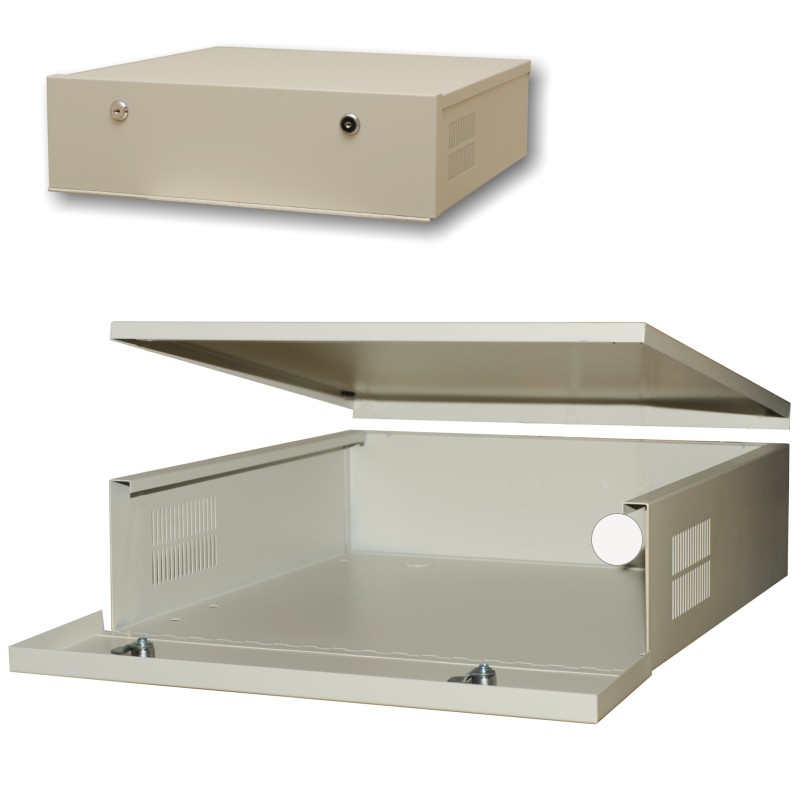

One thing I notice is that your DVR is not protected? You should consider getting a steel enclosure for it
so that the unit cannot be removed or damaged
Thanks. I did find some cctv signs and stickers on ebay and ordered them. The dvr lock box is a must. Where could I find one thats not too expensive?
