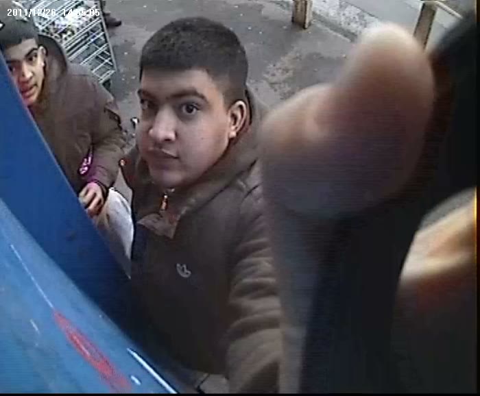

Hi. you have a avtech DVR. i have looked at your footage and you only have 5 seconds of them taking the camera so no point in video. however you can take a snap shot of there face. which is at 14.54 if you cant take the snap PM me and ill do it for you. you have 4 days left before it gets deleted.
were are you based and who fitted your camera 5ft high. the little guy must only be 10-11 and he can reach your cameras.
If you can view the footage, perhaps you should consider a cheap movie maker program and do a screen shot recording while you watch the dvr footage. That will give you a file that you can work with and save as any type you wish.
In fact, try this for still images- while playing the footage do a print screen. Pause the dvr footage at good ID frames and push PrtSc button on the computer keypad. That saves an image to the clip board. Then open a picture program such as photoshop or the like, make a new picture, and paste and the screen shot will dump in making the photo. Then crop the photo to just the drv image with date/time stamp and try not to make the image too large or it will lose sharpness. A bit smaller and clearer is better. With these approaches, you don't really need to convert the file if it's a problem. Best of luck.

hi. images and converted footage sent. if you have problems let me know.

By way of an update, the thiefs got a visit from the local police who identified them from the photos from the CCTV. They returned to the shop that evening to return the stolen CCTV camera and next day were "invited" to attend the police station for a formal interview. They have been charged and released until the court hearing which is yet to be diarised. Apparently police no longer release you on bail!! We may get some compensation for damages but the police officer doubts that we can reclaim the full cost of repairs, etc.
