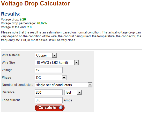

Soundy 1 Posted January 11, 2012 HAHAHAHAHAH plugging Cat5's gauge (24 AWG) into that calculator, with all the same parameters, yields this: "It is unlikely that this wire can support 3.6 amperes of currency at a distance of 200 feet." Even using all four pairs for power, you get 9.24V drop. Four 24ga. pairs yield approximately the same area (and thus capacity) as 18ga. Share this post Link to post Share on other sites
coreyman 0 Posted January 11, 2012 HAHAHAHAHAH plugging Cat5's gauge (24 AWG) into that calculator, with all the same parameters, yields this: "It is unlikely that this wire can support 3.6 amperes of currency at a distance of 200 feet." Even using all four pairs for power, you get 9.24V drop. Four 24ga. pairs yield approximately the same area (and thus capacity) as 18ga. That's exactly what I needed to know Thank you! Where is the link to that calculator? 3.6Amps is a rather large amount of power consumption! Share this post Link to post Share on other sites

Soundy 1 Posted January 11, 2012 Where is the link to that calculator? http://www.calculator.net/voltage-drop-calculator.html?material=copper&wiresize=52.96&voltage=24&phase=ac&noofconductor=2&distance=15&distanceunit=meters&eres=1.5&x=68&y=10 Share this post Link to post Share on other sites
Soundy 1 Posted January 11, 2012 yes this will also work. but just to point out something you have listed your PTZ as 3.6amp i think you ment 1.5 amp this is why all the calculations are wrong. we are only talking 60m (200ft) Calculated voltage at camera should be 2.8V... measured is 1.8V... not that far off. But there is another problem: the POWER SUPPLY he has listed as 1.5A... that would definitely account for the other lost volt. Share this post Link to post Share on other sites
