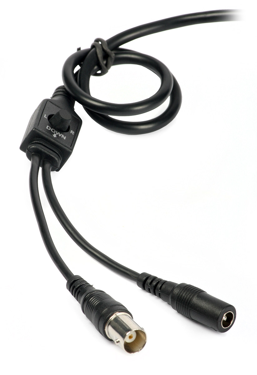

SEANHAWG 1 Posted February 13, 2012 A good effio camera should have one of those joysticks on the cable camera end anyways. Or atleast some buttons on the camera to adjust it. There would be no way to use this cable at the DVR end unless you have RS-485 connections on the camera end. Some have both buttons on the camera/cable as well as RS-485 connections. Share this post Link to post Share on other sites

tomcctv 187 Posted February 13, 2012 yes we use a universal OSD controller. but the camera has to be supported either via coax or rs485 not all EFFIO support it Share this post Link to post Share on other sites
