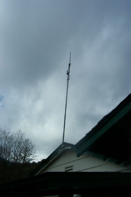

I've used the 11mbps radios from SmartBridges with success.
Here's a SmartBridges airPoint-PRO w/7dBi omni. It's on a 6.0/608 DSL circuit:
