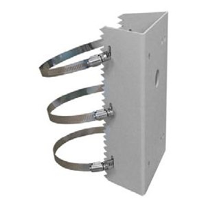

tomcctv 189 Posted April 11, 2012 quote. > The mounts are designed to swivel within available clearance limits, which adds to the flexibility, easy maintenance, and usability of the configuration. Manufactured from aluminum, the mounts include indexing bolts to secure the arm in position. the arm does come off (lock nuts) then you could use something like this. but its not cheap. Share this post Link to post Share on other sites
Installer024 0 Posted April 11, 2012 Yes I know the arm comes off, it accutaly comes in a separate box all together. It kind of defeats the purpose of the 300 dollar mount though. The purpose is to mount it close to the roof top so I could loosen and service the camera all from the roof. I thought about an attachment like this too, but then i need a lift to service the camera. I could buy any wall mount and accomplish the same thing. Keep it coming guys, please. Share this post Link to post Share on other sites
