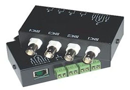

J-Telectro 0 Posted May 7, 2012 Hi, I'm new to Cat5 cable and I'm trying to figure out the best way to connect multiple cameras without running unnecessary cable. Scenario 1- I want to put 1 camera in each of 4 bedrooms. The main cable run should go down the hall that leads to the bedrooms,and then each individual camera should have it's own pair from the Cat5 main cable. I could strip the sheath off the outside of the main cable where the first pair must exit and then run the other pairs individually to their respective rooms. Or I could try to cut the sheath where each pair must exit and then splice a second Cat5 cable for each room. Total run for the main cable is about 60 feet and the runs in the bedrooms are not over 20 feet. There is no access to the attic so these runs have to be made along the ceiling or baseboard. I can either run a separate power cable or try to power the cameras locally. What's the best way to do it? Scenario 2- Similar situation but I want to install 4 cameras outside along my fence. The main run will be about 125 feet to the first camera then I need to split off to the left and right to the other cameras. It will be about 75 feet in one direction and about 100 feet in the other (for 2 cameras). What about waterproofing if I make splices? Runs will be done in conduit underground but it is common here to have water standing in underground conduit and junction boxes according to electricians I have talked to. I also plan a separate power run. John Share this post Link to post Share on other sites
pal251 0 Posted May 8, 2012 Get a 4 channel balun and possibly power the camera locally. A camera in the bedroom....creepy! Share this post Link to post Share on other sites

tomcctv 189 Posted May 8, 2012 hi. simple way is a 4 way balun at DVR then cat5 to area to another 4 way balun then coax from balun to camera. cat5 is always best as a single run with no connections. Share this post Link to post Share on other sites

J-Telectro 0 Posted May 16, 2012 hi. simple way is a 4 way balun at DVR then cat5 to area to another 4 way balun then coax from balun to camera. I'll give that a try thanks! I would leave the 4 port balun at the DVR and run the 4 cat5 cables to the cameras. Just find a way to get the wires there...has to be another way and cat5 is not that thick Yeah, I really need to rethink this. I need to find a better route for the cables. Thanks. One other question..do the newer IP and Megapixel cameras use all 4 pairs in the cat5 cable? Thanks everyone for your help, it saved me from causing myself a lot of extra work. John Share this post Link to post Share on other sites
