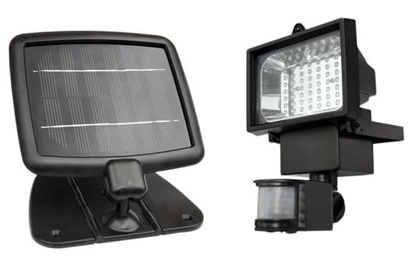

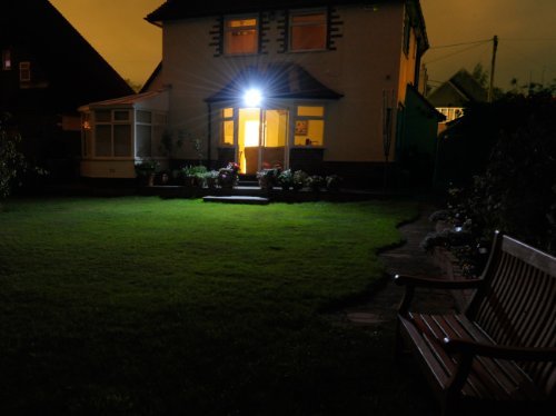

hi. if you need to watch your dogs or see if anything is on the ground that should not be there i would forget about IR and go with flood lighting. solar is a good option put light without power anywhere around your property.
Ok, so on one hand we have flood light, which is better for seeing what is happening, and in the other, the IR, which is better for long distance seeing, isn't it?

So, flood light is better than IR in any case?
