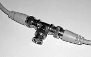

I actually think i have that quad switcher but can i use it with the dvr and still get recording done?
Im assuming is either dvr or multiplexer. Im kinda new to CCTV
Sure, just use video signal multiplexer 1-->2. Put one cable to DVR and second one to quad. Same with second camera. Then You'll have no problems with DVR - no one will change anything in menu - You'll separate DVR form preview monitor. It also has a bit of a problem - to playback You will have to go to DVR, but if You use it rarely, is shouldn't be such an inconvenience.
