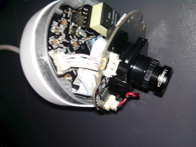

Open up the IPC-HFW2100 but quite difficult to remove the lens to change it even though I don't see any screws locking the lens into position.
If you will notice, there is a lock ring that screws down to the base to lock it into position after you screw it in and out to find the focus. It is a knurled ring right above the base, below the exposed threads.

Just noticed your lens is marked 3.6mm EGA. I am guessing EGA is a brand vs. the Mega brand on the 6mm lens in the Q-See version. Since you apparently didn't change the lens (yet), I am guessing you ordered it as a 3.6mm? 3.6mm is one of the two lenses I bought for my cameras and it focused, unliked the 12mm which couldn't screw in enough. The Mega brand 3.6 screws in almost exactly the same distance as the 6mm. I am assuming the 8mm is almost the same distance as it is the other of the three offered by Dahua.
