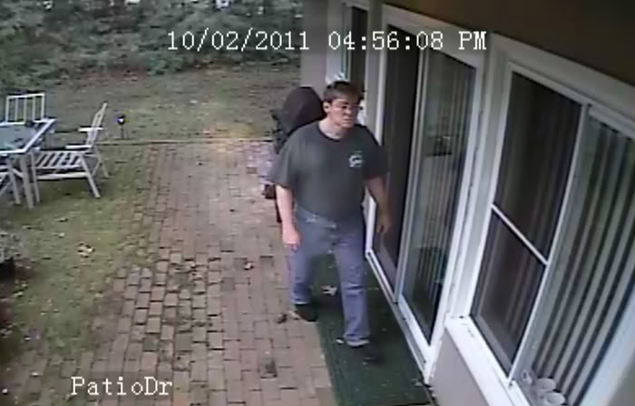

I think even the cheaper analog cameras would look fine as long as they were installed in a suitable environment. Technically, there are not bad cameras that anyone sells, it's when people install them in areas that the camera cannot handle.

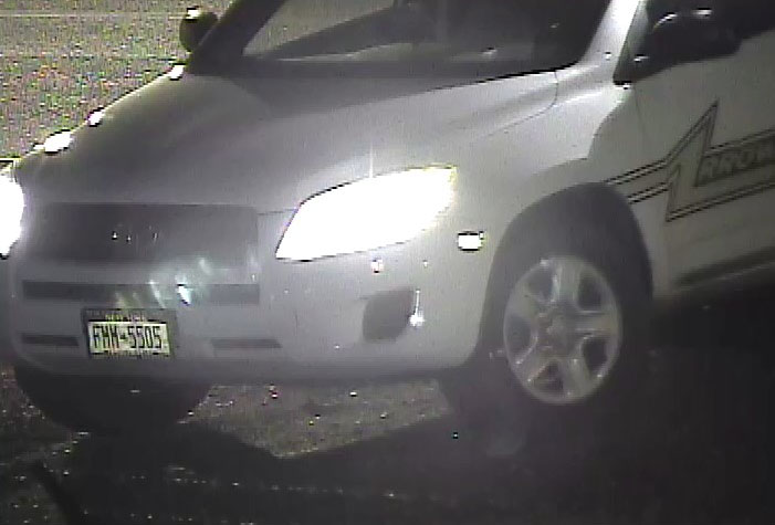

Huh, another positive ID with analog
And another
And another
And another
