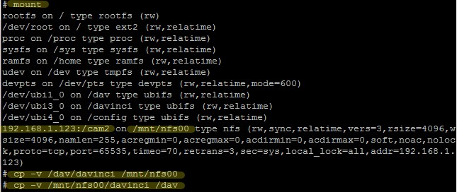

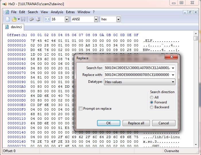

Followed the instructions for the hack I found on another site. Basically you need to telnet into the camera (I used Putty), copy the davinci file to your NAS, use a hex editor (I used HxD) to find: 5001D4C09DE52C00001A07005CE12A00001A and replace with: 5001D4C09DE50000000007005CE100000000. Save and copy it back. You can then reboot the camera and the NAS will still show up as 'normal' rather than 'unitialised':
1. Telnet in to camera ip address with username and password. Type 'mount' to find the NAS:
2. Copy file to NAS. Open with hex editor, find and replace string, Save and copy back to /dav folder.
You may need to set r/w permissions on the davinci file (I had to on one camera but not the other). The camera must be able to access the NFS share before you do the hack. Do this at your own risk!
