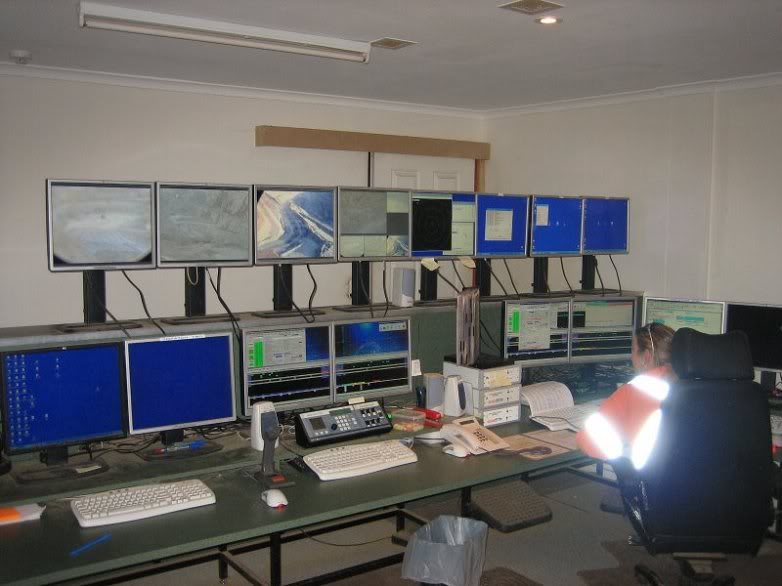

775143210_ChelmsfordBoroughCouncilsCCTVcontrolcentre.jpg.dc3e6e202c24fc6457bdb291a7e91eff.jpg
This is my control room. Its all IP. Only 4 of the 18 monitors normaly display video however 14 of them can be used at a moments notice. 4 can't as they are physically on a different network and the boxes are running Unix. (two monitors are behind the photograph)
So the other 10 monitors normally run email, heavy duty vehicle health monitoring systems, ground slope radar monitoring systems, GPS location systems, Lightning detection systems, databases and servers administration. There are 3 consoles (one you can't see because its on the back wall) that are on a shared KVM with direct connection to up to 31 computers. There are several heavy duty servers, that we never normaly veiw apart from administration. There are 3 SQL servers, 2 Unix servers, one backup server. There are 9 workstations each running duel monitors. All of these services can be replicated with the use of a password around the world (anywhere on our network)
