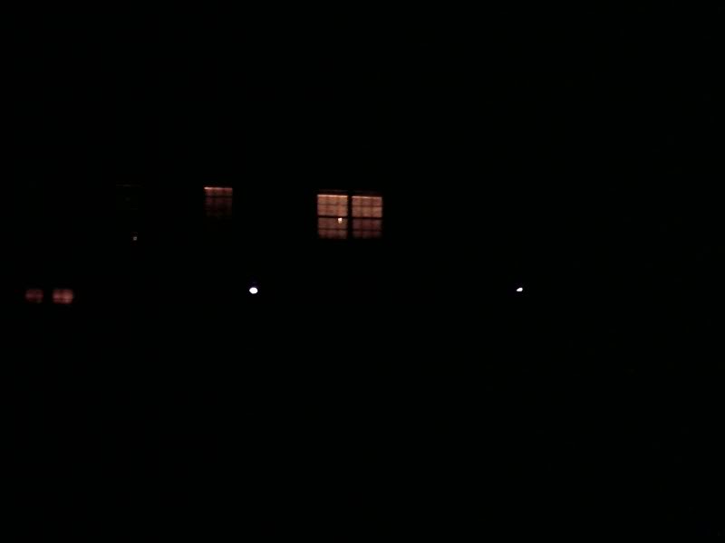

When I want to test if an IR device is working (remote control, IR emitter etc) I point my camera phone at it and I can see the IR light... I can stand at the end of my drive with an IR filter and my cellphone and all my cameras jump right out at me.
Seems like this could be a risk in terms of someone identifying the location of cameras/emitters.
Any suggestions as far as getting around this? I was thinking maybe installing a shield/visor that would hide the IR Emitter from areas that are not covered by it (so you can't just drive past the house and use a camera phone to identify the locations of the cameras).

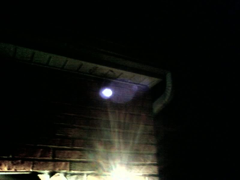

The two white dots are IR emitters
yeah, but who would know what they are?
Could be anything .. yard light or something.
They are not visible to the naked eye. Hold up the phone in camera mode and compare the phone image with what you can see. any bright white dots that only appear on the phone = IR emitters.
