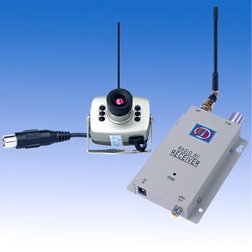

I hope by "professional wireless security camera", you are NOT refering to these. 75639_1.jpg Basically give crappy images.
And YES, you'll need PAL cameras if you set your system to PAL. and NTSC if you set it to NTSC (The DVR can switch between both if i am not wrong). You can't mix the 2 signals together, i.e. 2 PAL cam and 2 NTSC cam. the one on the wrong signals will give you problem when recording. Basically the signal doesn't syn and the compression will be crappy.
The camera and transmitter/receiver are in the images attached. The problem is the DVR always remains on PAL and won't swtich to NTSC even following the instructions. any idea why?
