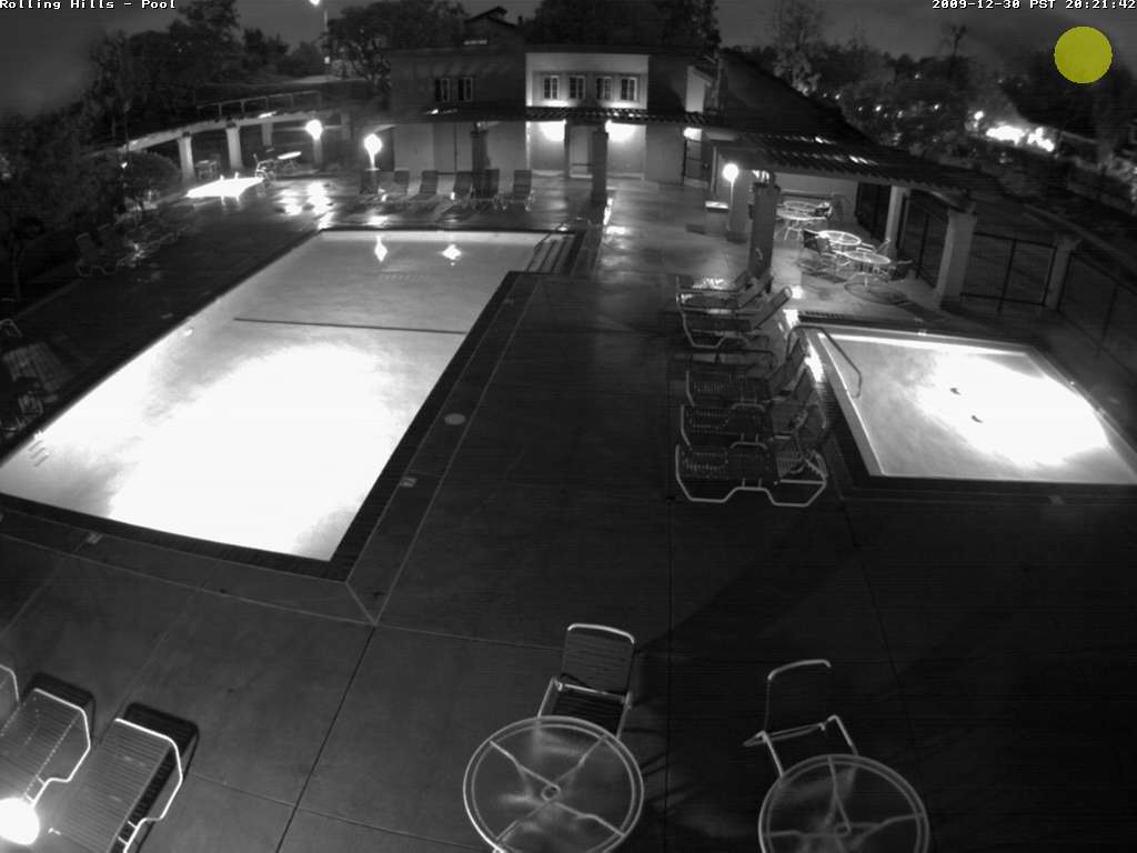

To do good low light, I feel you need a dedicated b&w sensor like on the Mobotix M12-SEC Day/Night. There are some cameras like Arecont that boast their Moonlight mode, but really, it's just an extended exposure per frame, so what you end up with is a fantastic sharp night shot as long as nobody is moving. Stardot claims they can maintain a color image in less light than Arecont or Mobotix, but of course, that's the point, color, you really need to go b&w to get true low lux.
From what I can see, from red light cameras and toll road evasion cameras and my vacation point & shoot camera, they all have one thing in common, a flash. If you need to capture a nice crisp color shot that's sharp even with motion, you need a flash or a powerful light. The red light cameras by me use 2 lights per camera that are huge, about 2' long and 10" diameter and they blind you when you drive through, but they work. Alternatley you can get some IR panels that are invisible or near invisible light, but that's for IR, which is b&w anyway.
This is what I get from our Mobotix on a none moonlight night, just with some fluorescent ligths in the pool area which are terrible for IR.
