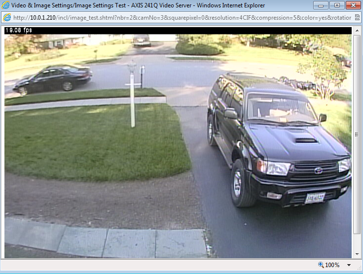

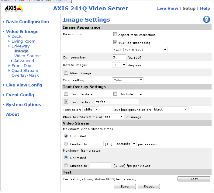

Here is my setting directly in the AXIS setup page (unlimited fps), not exacq:

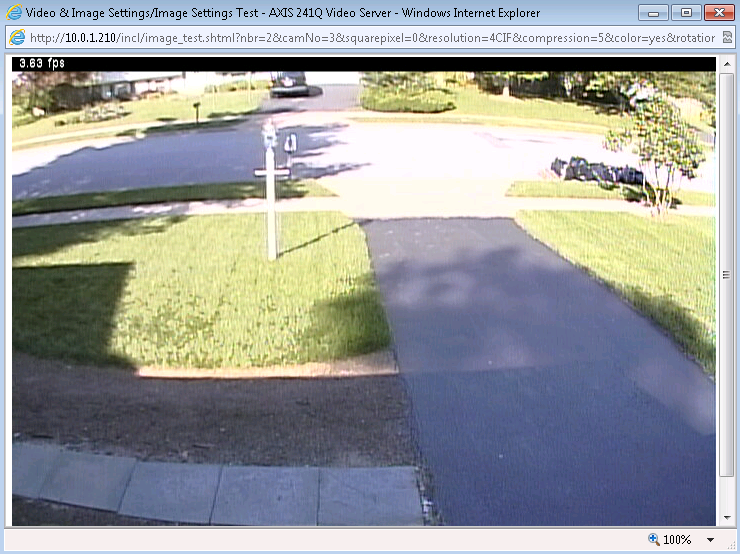

And when i click on "test" in the AXIS setup page, here is the pop-up window that measures FPS (note the top black bar that shows the FPS), which has nothing to do with EXACQ, although I havent officially disconnected exacq from the Server:
And when I export recorded video from Exacq, and then open it in Quicktime, and look at the video info, quicktime shows it as 4fps too.

un-check the encoder from the "IP cameras" page then log into the encoder and tell me what the FPS is in the live view.
Im just tested one of mine and its getting 30fps. Though another one i tested is getting 4fps like yours
How many cameras do you have hooked up to your encoder?
between 19 and 20

As of right now though, the RFPS, DFPS, and FPS are all about 3.6 -- Can you tell me what the R and the D stand for? In otherwords, what is the difference between the three?

Didnt end up having to leave yet, so I did a quick default on my AXIS 241Q.
The FPS (while not connected to exacq) went from 19 (before) to 26 (after the default). The FPS (while connected to exacq) went from 3.5 (before) to 5.2 (after). 5 is still a bit on the slow side. I think maybe this has something to do with the dual streams, or is it something else?
EDIT: after re-setting up my motion windows, my fps is back down to 3.X Everything is default in the AXIS settings except I gave each camera a name (for example, front door, driveway, etc). And then the only thing I did in Exacq was raise the quality of each camera from 5 to 10, and then setup motion detection windows.

Im just wondering why if the encoder is disconnected from exacq I can get 19 to 26 FPS, but the instant it connects to exacq, that drops to between 3 and 7fps. Something has got to be wrong somewhere...
When you are viewing the encoder directly you are only viewing one stream. When you have Exacq connected Exacq is pulling 4 streams.
