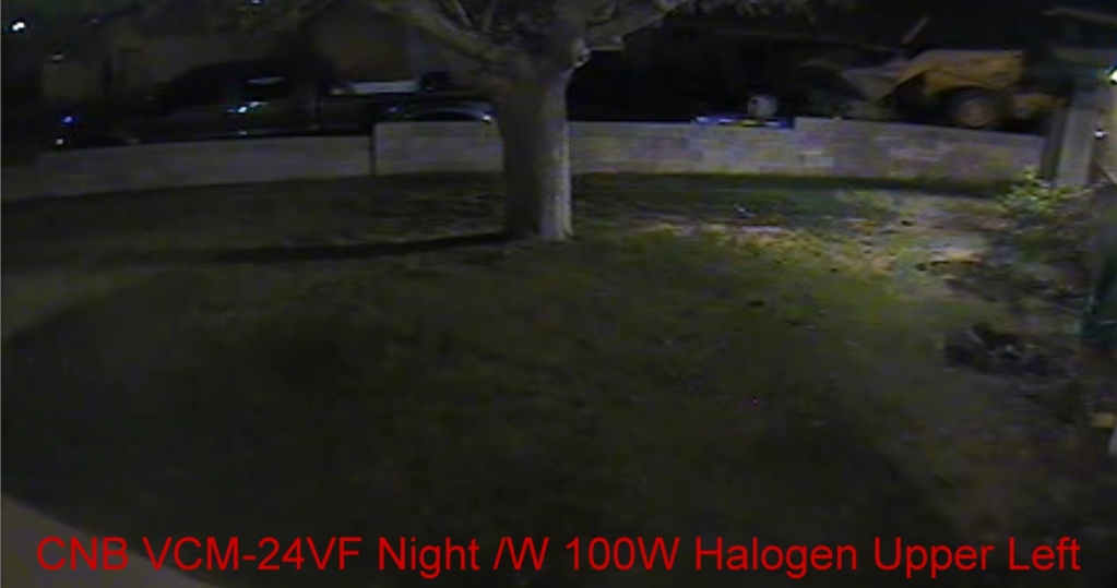

HTElectrical 0 Posted September 15, 2011 CNB contacted me this afternoon and said "they do not have any problems with that camera not switching to Night mode". I told them Ya right!!!!! I am going to contact DWG and see about an RMA and maybe a different camera. Here is a night pic using a 100W halogen in the far upper right hand corner. It wouldn't be that bad if it could accomplish that image with no extra light, like the Mintron. Share this post Link to post Share on other sites

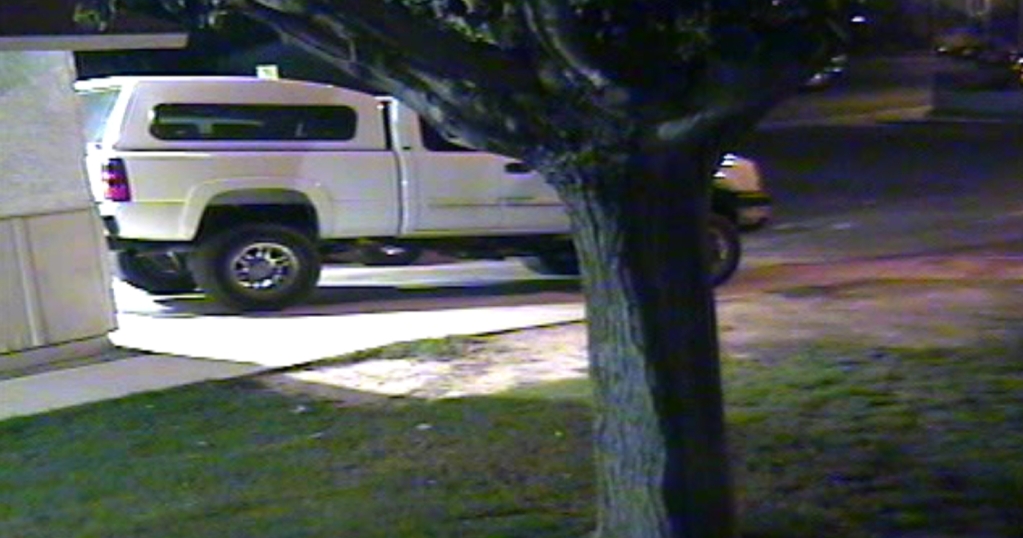

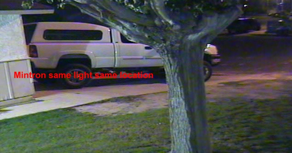

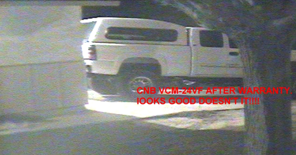

HTElectrical 0 Posted October 12, 2011 Well this is what it looks like in the exact same position same light etc.... CNB sent it back to me after I sent it in for warranty and I quote We checked out the camera and we found that the Day/Night function was on Color. We initialized the product and all functions are working fine. If that is fine than CNB really SUCKS! Mintron camera for comparison. Share this post Link to post Share on other sites
shockwave199 0 Posted October 12, 2011 Apples to oranges. You're comparing a 200 dollar camera to a 600 dollar camera. Sorry, but you got a 200 dollar lesson- don't buy this camera. Shame you couldn't return it, or can you still? That mintron looks excellent. If it wasn't so much money I'd surely get eight of them myself. You can try cheaper cameras and maybe find one comparable to that mintron in those lighting conditions, but it's a crap shoot. Buy with a return policy. Good luck. Dan Share this post Link to post Share on other sites
tomcctv 187 Posted October 12, 2011 Well this is what it looks like in the exact same position same light etc.... hi. never had a CNB as bad as that. BUT i would say it is a setup problem. you cant compare those two images as the lighting is not the same in both images. CNB you have the extra lighting infront of the camera and on the Mintron you have it behind the camera Share this post Link to post Share on other sites

HTElectrical 0 Posted October 14, 2011 Well this is what it looks like in the exact same position same light etc.... hi. never had a CNB as bad as that. BUT i would say it is a setup problem. you cant compare those two images as the lighting is not the same in both images. CNB you have the extra lighting infront of the camera and on the Mintron you have it behind the camera Ah yes I can compare those 2 images. The CNB is mounted 1 foot below the Mintron and the image was taken at the same time for both cameras. Share this post Link to post Share on other sites
HTElectrical 0 Posted October 14, 2011 Apples to oranges. You're comparing a 200 dollar camera to a 600 dollar camera. Sorry, but you got a 200 dollar lesson- don't buy this camera. Shame you couldn't return it, or can you still? That mintron looks excellent. If it wasn't so much money I'd surely get eight of them myself. You can try cheaper cameras and maybe find one comparable to that mintron in those lighting conditions, but it's a crap shoot. Buy with a return policy. Good luck. Dan Actually, suggested retail for that camera is 360.00, and that is only because it is a 22X optical zoom camera, which does not make the image any better than the CNB, just enables it to zoom in on farther objects. Share this post Link to post Share on other sites
shockwave199 0 Posted October 14, 2011 Well then the place I found listing it....sucks. Share this post Link to post Share on other sites
SEANHAWG 1 Posted October 14, 2011 the image was taken at the same time for both cameras. Are you sure? It appears the light for the garage is on on the CNB pic and the Mintron is obviously not. Share this post Link to post Share on other sites
HTElectrical 0 Posted October 15, 2011 You're right, there you go. Share this post Link to post Share on other sites
SEANHAWG 1 Posted October 15, 2011 oh yeah, your right. Dang. I agree that Mintron looks excellent. The only thing about those CNB's is they dont switch to B/W very easily. I would bet that picture would be alot less noisy if it was in B/W mode. II would bet that since its not in B/W mode that the IR filter hasnt slid out of the way either which makes it look even more poor. I have some cameras that switch to B/W actually too easy and I have to turn the Day/Night setting almost all the way down to prevent it. Sometimes with CNB, you have to turn the Day/Night all the way up to make it switch and that even isnt enough sometimes. Share this post Link to post Share on other sites

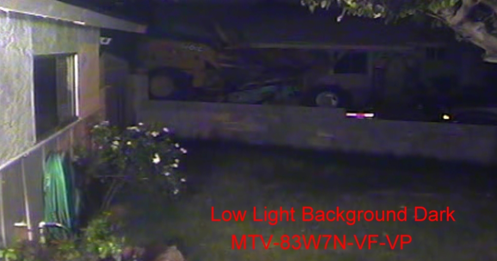

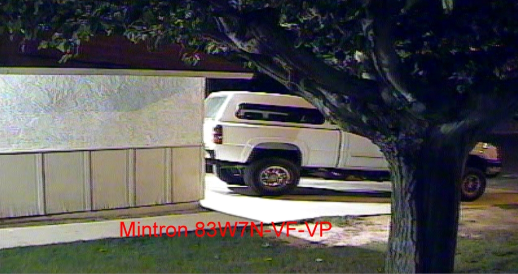

HTElectrical 0 Posted October 15, 2011 Here are a couple of images of the Mintron 83W7N-VF-VP Share this post Link to post Share on other sites
mike_va 0 Posted October 15, 2011 The datasheet I found implied the Mintron runs at 4x sense up (slow shutter). Can this be disabled? If this is at 4x sense up it would not really be a fair comparison. For example, two pics - one at nominal, one at 4x sense up. The fence in the background is only visible with the 4x. Share this post Link to post Share on other sites
HTElectrical 0 Posted October 15, 2011 Yes, you can disable the sense up, but why would it be unfair? The image is great, the video is smooth, not choppy, and you can get a better color image than most black and white cameras can provide. Share this post Link to post Share on other sites
SEANHAWG 1 Posted October 15, 2011 but why would it be unfair Because at slow shutter speeds you tend to get some motion blur on fast moving objects. On most applications that camera would be fine but on some it would not such as trying to capture moving vehicles and such. Nonetheless, its still a great looking image compared to other cameras I have seen with the same type of shutter settings. Share this post Link to post Share on other sites
