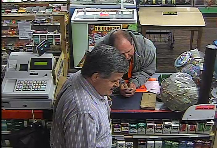

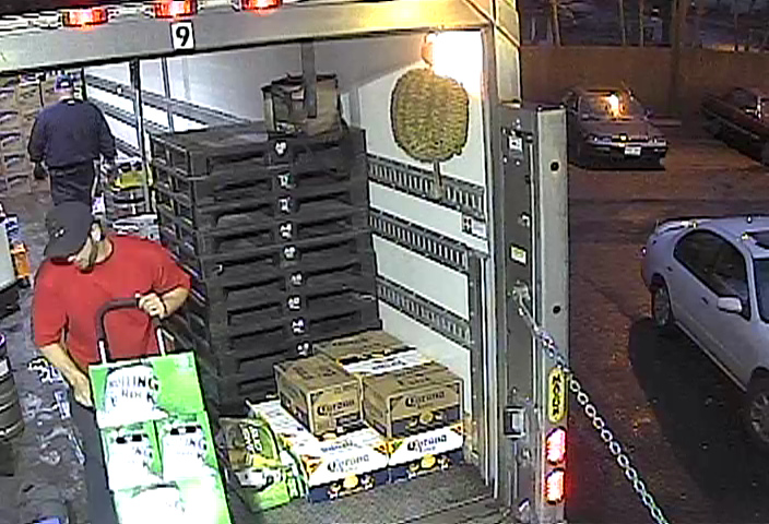

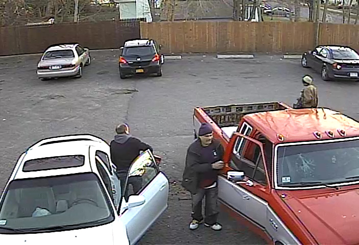

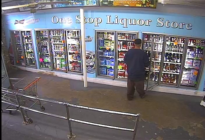

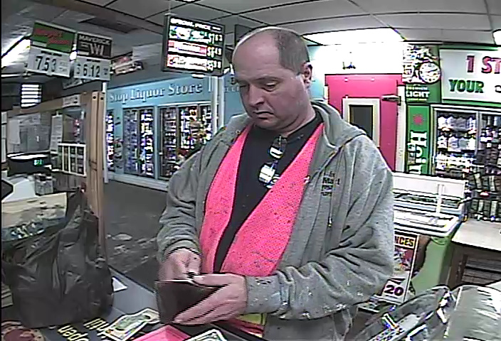

here is some samsung cams from a recent job with samsung dvr. you think you can get better images from these cams with an encoder.
do you think standalone ip encoders have superior image quality than a decent modern day analogue dvr???
nope
the outdoor is sco-2080 indoor is scd-2080...the one on the counter is an ATV Tower cam..that cam is 1/4" sensor. it is a tiny bullet cam that fits in the tower....i think that recorder set at the highest level with the new firmware has good quality recorded images
