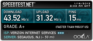

Thanks guys.....yes approx 30mbps, I will be at computer and will post a snap of the speediest....what I meant with the switch is yes the cameras can connect to the 10/100 ports but was planning the dvr and router to the gig ports....but if I didn't have gig ports would there be a difference?

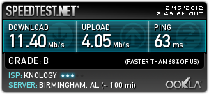

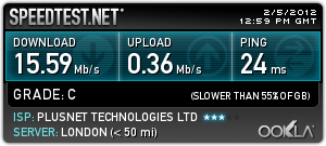

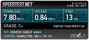

Sean and Wireguys, LOL....here ya go
Oh yeah, Verizon Fios. I heard thats killer fast. Fiber Optics all the way up to the house from what I understand.
you are correct my friend...
We are working with a local ISP to secure their substations. Minimum connection speed between locations is 1GB and most are 10GB. I am going to build a house within 300ft of one of the locations and run a cat cable. I would be plenty happy with a 100Mb connection
Mine's supposed to be 50Mbit down, 5Mbit up... Speedtest doesn't do it justice though, because of all the traffic we have going all the time.
