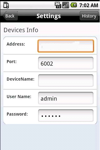

tomcctv 187 Posted July 29, 2012 address ...... you need your external ip (from link) Port ......... they say use 6002 you will need to portforward your dvr ip to 6002 or try the port you have already forwarded replace 6002 with 9000 Device name ........ just call it CCTV User name and password are admin Share this post Link to post Share on other sites

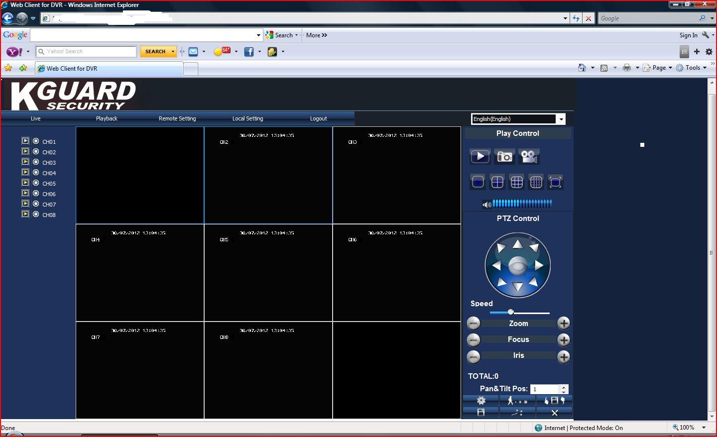

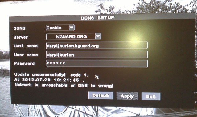

dazza12345789 0 Posted July 29, 2012 (edited) Thanks a lot for your help, On the PM, Neutech said about using a DMZ to save port forwarding as that is proving to be a pain with the Home Hub v2. So in my Hub settings, it showed that 2 devices were on attached by ethernet, my computer and the DVR - i used the DVR device to assign the DMZ to - i know this is not an IP, but when i click on my DVR on network settings, the IP is just 192.168.001.100... this seems too generic so thus cant be right, correct? As i can't have a static IP, I went on KGuard.org to create a DDNS, and they gave me a domain name, so i put that in the the DVR, Here are some pictures of what is going on: What the main network screen on the DVR looks like (I can change 'Static IP', to 'DHCP' or 'PPOE') Once clicked on DDNS, this is happening: (Note the error?) To add to this, i downloaded 'ASEE' on my phone, and after putting in the details that you told me to, it said it connected to the server yet no picture turned up? ] And here is showing my hubs settings and the device 'Unknown' is my DVR, so have assigned the DMZ to that. What is coming up on my phone (I should mention that this is a HTC, im doing it on, not sure if that differers things?) If i can provide you with anything else that would help, please just ask, you are doing me a massive favour. Thanks again Daryl Edited July 30, 2012 by Guest Share this post Link to post Share on other sites

tomcctv 187 Posted July 30, 2012 Hi. just looking at your posts and found this you have a gap between darylj burton.Kguard.org you can have a gap this is why you have unreachable in your listings Share this post Link to post Share on other sites
dazza12345789 0 Posted July 30, 2012 I am no longer using .kguard.org - instead using .zapto.org (via no-IP.com) and the problem of it not reaching the server is fine, just now it is saying my username/password is incorrect. I can use the same username/password to log into no-ip.com account, yet, on the DVR and web browser client, it is saying the credentials are wrong? Is the username/password something different... Something I have missed? Thanks for the input though, nice eyes as well - I have rectified it now but the problem of username is still persistent. Cheers Share this post Link to post Share on other sites

dazza12345789 0 Posted July 30, 2012 So, we are working? I can do LAN, but now I can do it externally? Whenever I type in my username/password after putting 'daryljburton.zapto.org' into my browser, it doesn't allow log in as it states my username/password is wrong? What did you use? Plus, when I do it on a app on my phone (IP viewer), it says 'failed to retrieve image from camera'? And on 'asee', I connect to server, yet no image? I'm sorry for being such a pain, but thanks for your help so far! Share this post Link to post Share on other sites
