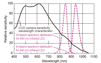

Anyone know if these HD-820's are sensitive to 940nm IR?
Cameras that can see 850 nm IR can generally see 940 nm as well, but with lower sensitivity. How much lower depends on the sensor specs, and those can be hard to get.
You can assume half the sensitivity as a rule of thumb, but you won't know for sure until you try it.
Edit: Here's a typical response chart; each sensor will be a bit different.
