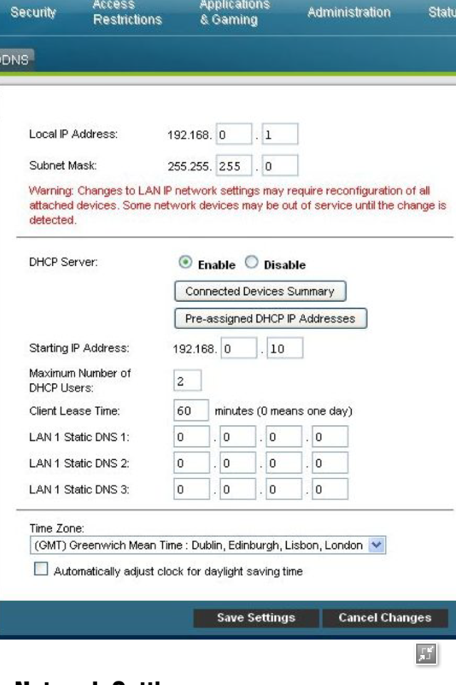

I have a Cisco DPC3825 Cable Modem/Wireless Router. I cannot do an ip address of 192.0.0.100 as shown on the pic of the menu. Is there software that can change the ip address of these 1080 IR Bullets to match my LAN parameters?

Rick, change your IP4 config as follows...
IP Address: 192.0.0.100
Subnet Mask: 255.255.255.0
Default Gateway: 192.0.0.1
(Don't worry about the DNS servers)
After reconfiguring your computer reboot it because why not waste some more time. Make certain that your computer and your Swan camera are plugginto the same router and that the camera is getting power. It takes the camera a few minutes to boot so be patient. Then start your broswer which will timeout and not be able to find your home page (this is normal when you change your IP address like you just did). Then enter 192.0.0.64 in your browser address bar and hit enter. Login with admin>12345 (if I remember right). Once you are logged in, change the IP address to a static address which matches your local area network scheme and save your changes. Then, change your computer's IP address back to the way it originally was. Then restart your broswer and browse to the static IP address your assigned to your camera. That should do it bro.
I have a Cisco DPC3825 Cable Modem/Wireless Router. I cannot do an ip address of 192.0.0.100 as shown on the pic of the menu...
You don't change the address of your router, you change the IP address of your local computer.
Sorry.......my bad! Thanks.
