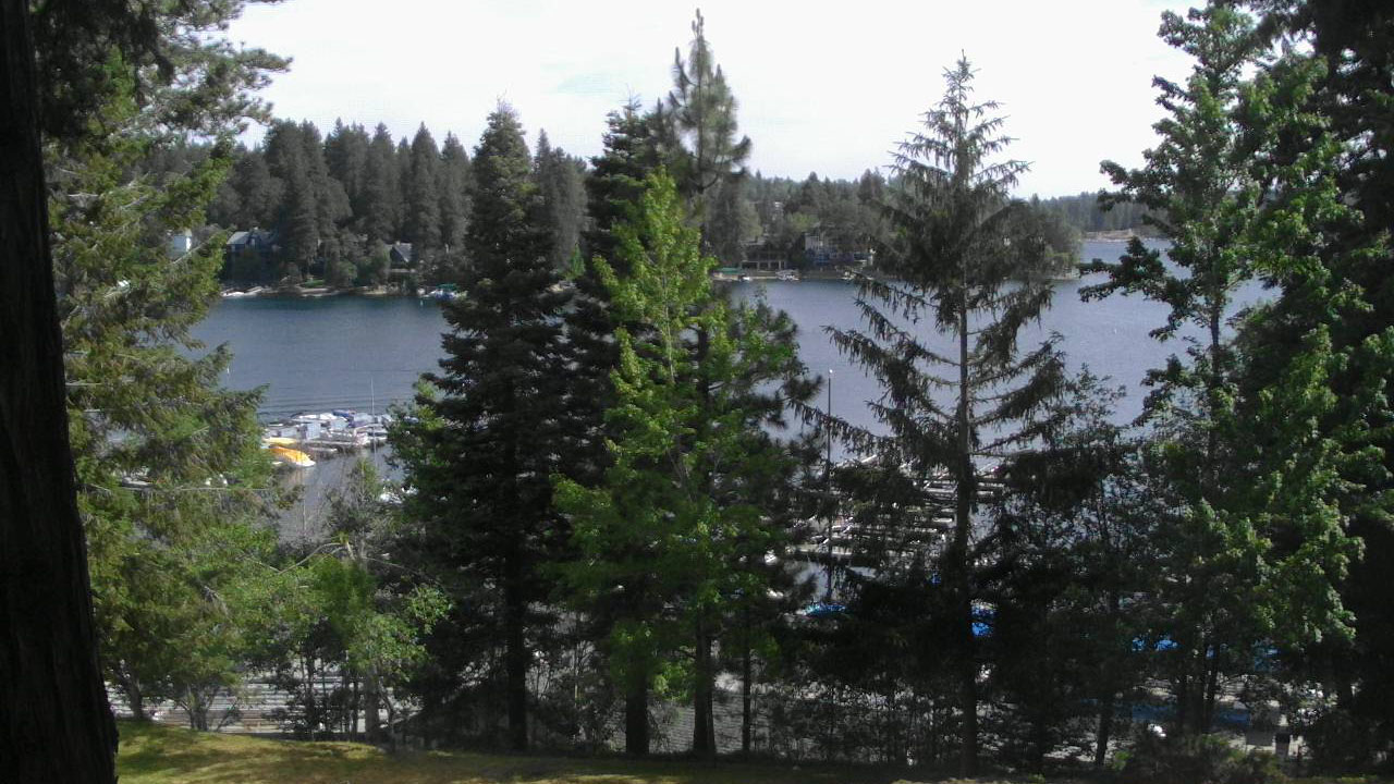

I will leave you with this thought. This is a Dahua hfw-2100 image during the day looking out the window of my lake house (soon to be replaced with Hikvision, so if you want to buy it, let me know)

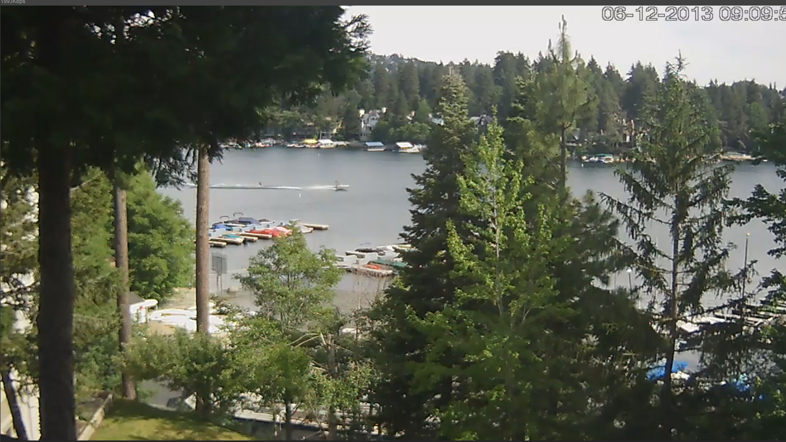

This is the same shot, different window with an indoor AVTech AVN812. You can see the greater detail, the much better color accuracy, the detail in the texture of the water and trees. I would say the Hikvision mini bullet or ACTi E32 is comparable to the AVTech in this regard but at 3MP.

Small glitch: you are using different angles, thus the AWB it's not the same (along with a different skyview).
Also, do you use them behind a window? Is that a double/tinted window?

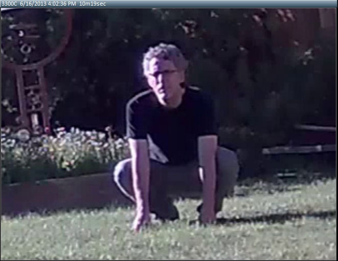

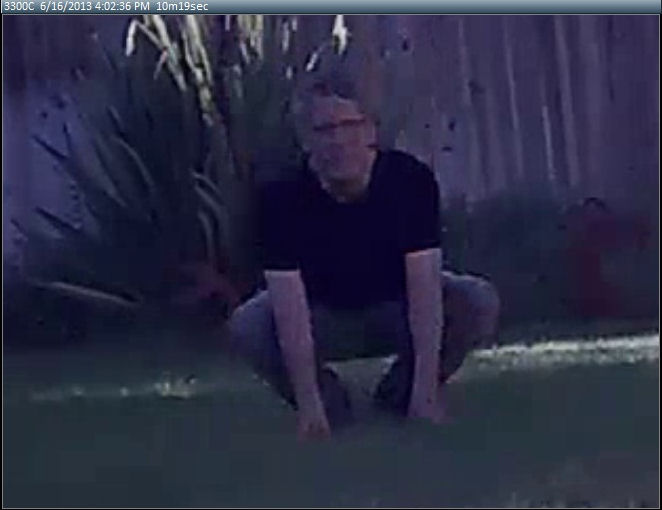

Here's an example that's not just leaves on trees, but shows the basic issue with Dahua's softness in shadows. It's a bright afternoon; plenty of light - this shouldn't be a challenging situation.
Each of these is around 25' away from the camera, which is set for 3MP and 8192 kb/s, with the lens pulled back to 3.3mm. I've used Blue Iris to zoom in on the appropriate portion of the image; zoom didn't change on either capture.
In the well lit part of the yard:
And in the shade, just a few feet to the side:
This is why I consider Dahua's softness to be a problem.
