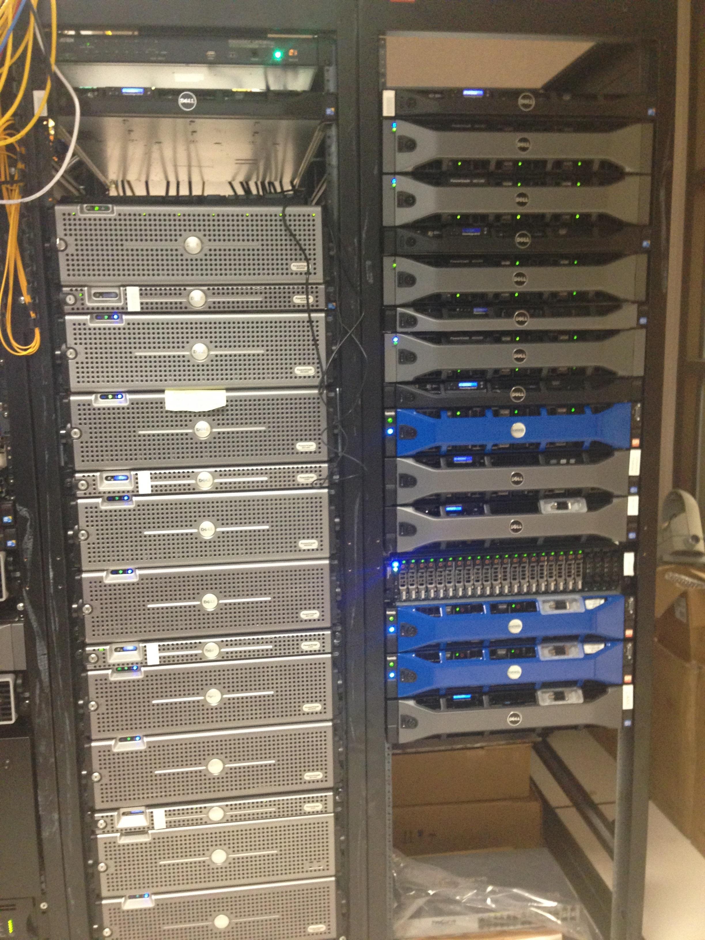

HBA's implies a SAN, not sure it's any faster than a modern day NAS. I've tested EMC's SAN for a join project on/off for a year until the product was ready to take to market and I can tell you that if you really tune a SAN or NAS, maybe you can get it to the point where it's 1/3rd the performance of direct attached disk but I'm talking their low end SAN, $300K range. What we did to mitigate the slowness was to mix internal drives to get the aggregate performance of both.
Sorry for the confusion.
It's a EMC NS480 NAS but since we are using HBA cards it sees it as a SAN.
I agree direct attached storage is the best.
We do a lot of that too.
Hah! you guys with your ridiculous budgets... I'm Jealous.
going to try REFS for the file system and see if that helps, if not then change the host disk file system, if not then try splitting the disks into pairs of arrays (going to be messy but meh.)
I love server PORN
