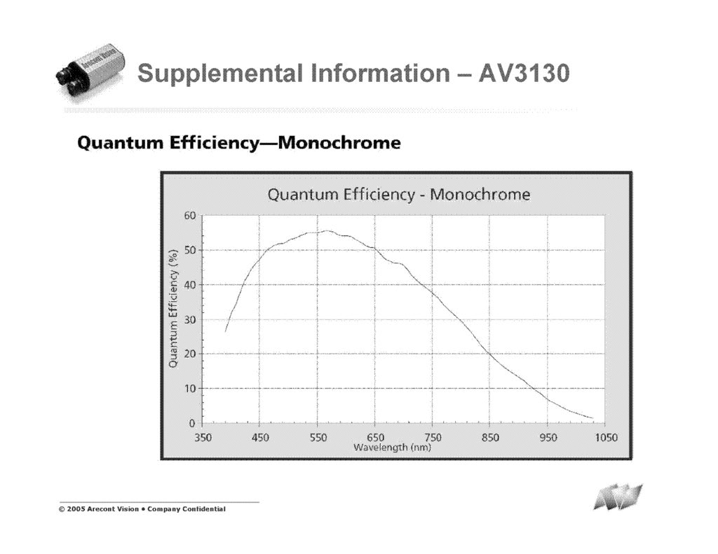

Well, I just finally got mine to work, I am WOW with the quality of the image, but still trying to determine how to make the night sensor work better than what it is. The application where this camera will be installed will have barely moon lighting, so I want to know if an external IR beam will work? Mainly looking for a wide beam. Any ideas?
I would expect the application of an IR source to be no different than to a normal CCTV camera. It's a matter of matching it to the lens FOV and distance to the subject.

You need to find out what the Spectral Response is, at that will matter when it comes to IR. Also not all cameras are as sensitive to IR as others.
Gotta tell you, I have read things about tech support from this company, did try to call, but no answer, so I called their eastern rep, Jason, and he told me everything that I need to know about this system, very happy with the info that he provided, so I guess that they are listening and hopefully their tech support will get better in the near future.
Anyway, rorymon, he sent me a PDF with the info you asked for:
Thanks.
not very flash specs.... unless you flood the area with green !
they really need to get a better sensor in there
