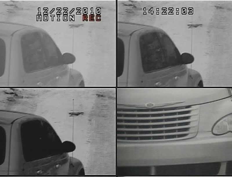

The IR camera is recorded on a dedicated 4 channel DVR on channel 1. Then channel1 is looped out to channel2 input, and chan2 to chan3. This gives me 3 identical images. Each has different brightness and contrast settings.
Ohio Plate, Stamped...
Front plate:
IR Camera:
Backup visible light camera:

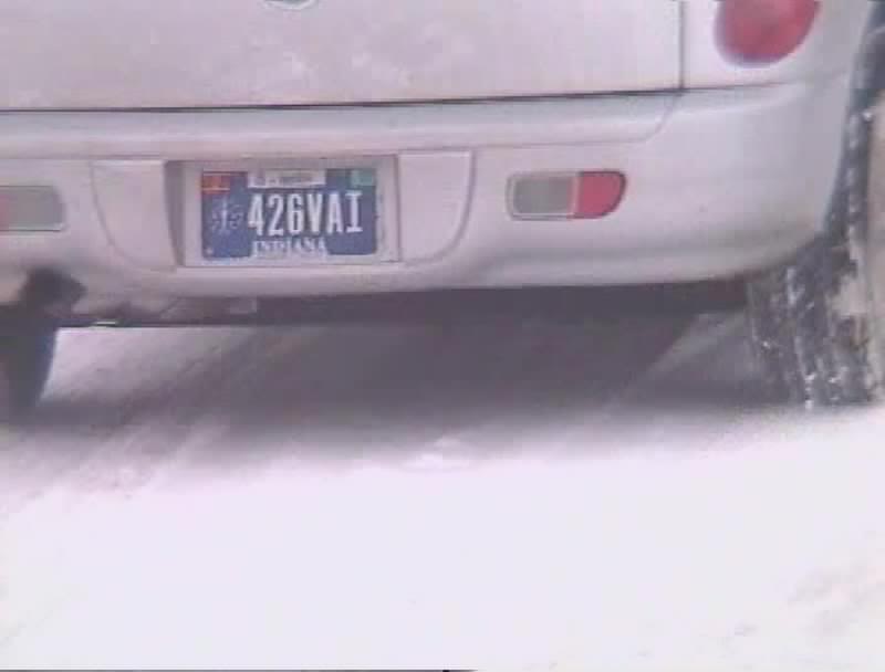

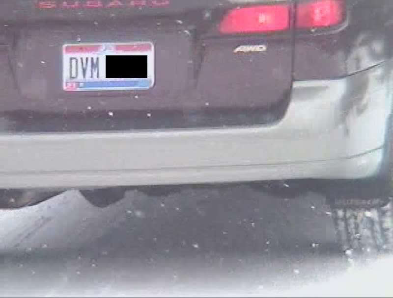

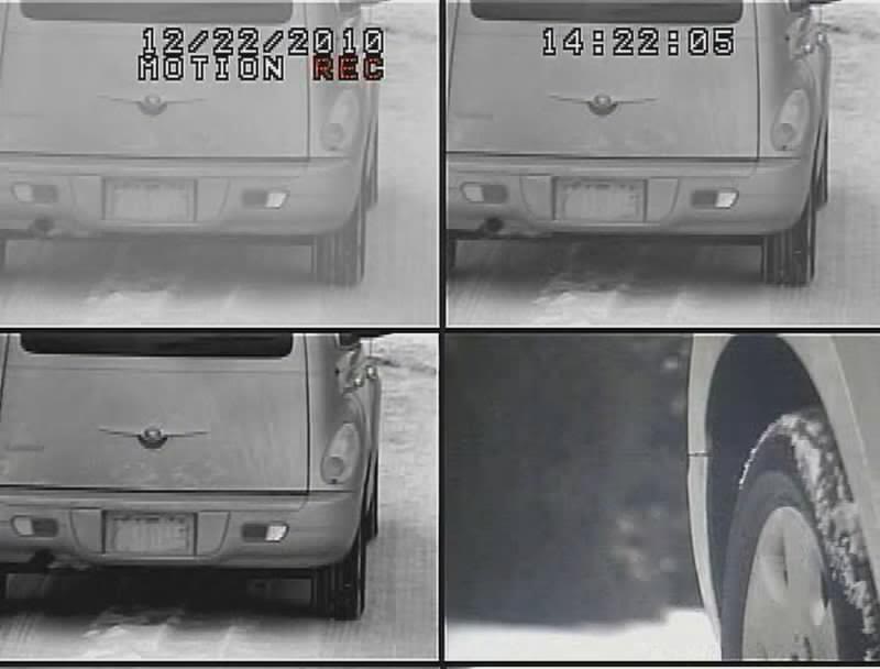

Here's what I get for an Indiana plate (printed)
No front plate for this Indana-registered rental car:
Rear plate is invisible to IR:
Rear plate caught by backup visible-light camera:
Looking at these images again, I think I need to zoom my IR plate camera in a little closer if I can...
