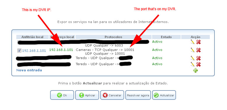

This is my DDNS: lunaeyes.dvrdns.org where I login into my DVR.

Sounds like a command/control port is not open in the router.
So why can i see the cameras but not move them with scdvr?
But outside my home I can move the cameras with a laptop. But not with scDvr.
If I login at http://lupus.dvrdns.org:10001/ with 'test' and pass 'test' I can see the cameras and move them, but when I login at lunaeyes.dvrdns.org with 'temp' and pass 'temp' I can see the camera BUT not move them.
I have a Lupus Aeon 800 with PTZ Sony cameras, I think that http://lupus.dvrdns.org:10001/ has the same haedware....

My DVR is on the Internet, because you can see the cameras via the lunaeyes.dvrdns.org DDNS.
if connected but no image try and change your port number from 10001 to 80 and also set your image quality down on your dvr
I changed to port 80 but no luck...
Since it works from a PC then the router is configured properly.
Its something to do with the iphone app you are using.
