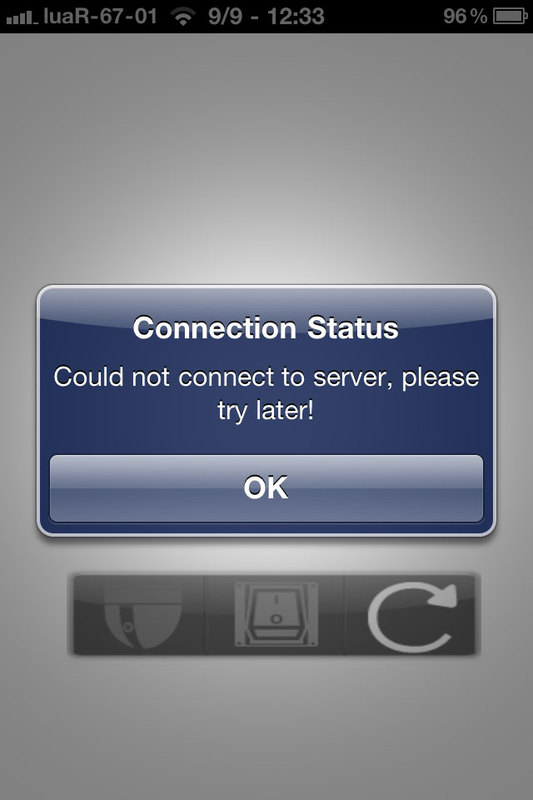

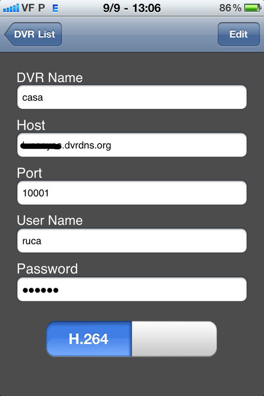

rucanunes 0 Posted September 9, 2011 Someone, please? I still can't find a solution to move the cameras. I tried to use Budo Budo, but with no luck. Can't connect. Tese are my settings and the message I get with Budo Budo: Any ideas or new software? Share this post Link to post Share on other sites
tomcctv 187 Posted September 9, 2011 is this the same problem................. your problem was cant move PTZ with iphone. looking at your screen shot you cant log onto the app. can you pm me your ip. Share this post Link to post Share on other sites
rucanunes 0 Posted September 9, 2011 is this the same problem................. your problem was cant move PTZ with iphone. looking at your screen shot you cant log onto the app. can you pm me your ip. I can login on th scDVR app but can't move the cameras. On the Budo Budo, I can't login. Share this post Link to post Share on other sites
