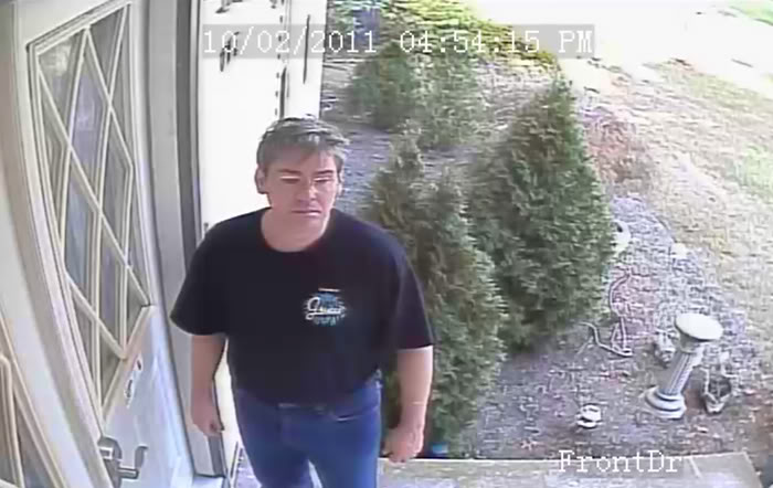

Far as WDR, this same front door cam I use has it- in this camera it's just auto, always on. Whether it's real, fake, or whatever, it does do a good job on bright days when people at are my door which has a roof overhang, making it darker in the foreground. On real sunny days when the range is extreme, it still does very well. And I just noticed, this cam picks up the scar on my left arm. Well I'll be- damn good. This was a cheap 60 dollar camera but it still kicks arse. I don't think they carry this particular one any longer though.
Yeah, I watched the videos of your cameras in your sig. Looks good,
def need some form of "Smart IR" or whatever it is. Because My flood lights keep the porch real bright, and the yard just enough to be able to see. So when on the porch someones face is just pure white and lit up too bright. But, I know alot of that was because of the Cheap cameras I had before.

The front door cam in my vids is a qsee, which has been replaced by the gadspot I'm referencing above.
The problem with blasting light is this, a pic from another very good camera at work-
The only fix I know of for that is to adjust the light fixture itself- either the bulb wattage/type, aiming away from direct face on, or moving the fixture itself altogether. Better to do that than expect any camera to deal with too bright light in the face.

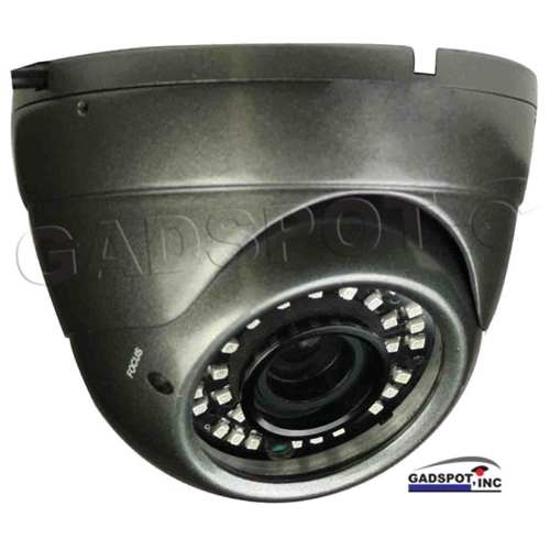

ok, Looking at Gad spot. I have a few options.
Note: I notice they use a different version if LED. Guessing it's a better version....
GS4030SM - 650 tvl $60
1/3" Exview WDS
3.5~8 mm Varifocal
S/N Ratio > 50dB
GS830SM - 700 tvl $95
Sony 1/3" EXview HAD II CCD
4~9 mm Varifocal
S/N Ratio > 52dB
osd menu etc....

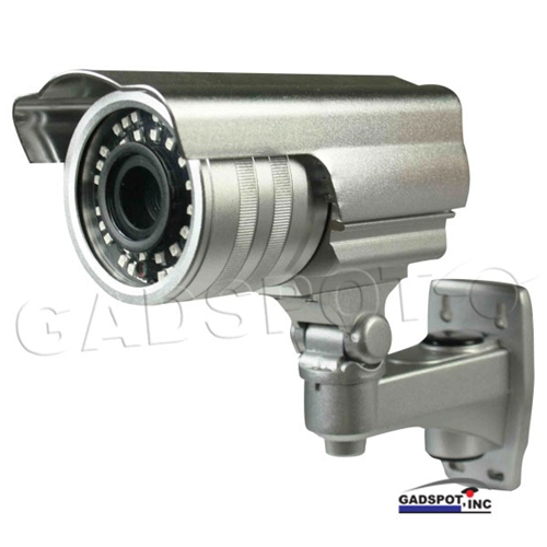

Then, The Bullet versions. Which, have slightly better specs vs the Domes. For the same price...
GS831SM - 750 TVL $95
750TVL High Resolution Day & Night w/ IR cut filter (removal) and Smart Light Control CCTV Camera
Effio platform 750 TV Line
Lens: 3.5~8mm Varifocal, Million Pixs Auto Iris Lens
OSD Menu for camera parameters
Built-in powerful IR LED illuminator
Min illumination: 0 Lux (with IR-LED on)
True Day/Night feature with IR cut removable module
Capture images from vehicles traveling at speeds up to 30 mph (50 kph)
Weatherproof (IP66 standard)
S/N Ratio 52db
GS4031SM 650 tvl $60
650TVL High Resolution Day & Night w/ IR cut filter (removal) CCTV Camera
650 TVL 1/3" Exview WDS High Res. CCTV Camera
3.5~8mm Varifocal Lens
Those are the 4 Smart IR cameras Gadspot offers.
I don't see anything saying they have 2 or 3 dnr. :shrugs:
I kinda want the 3.5 lens over the 4. BUT, the 4 just has so much better specs
compared to the 3.5 if I'm reading it correctly. between S/N ratio, sensor type and size etc...
